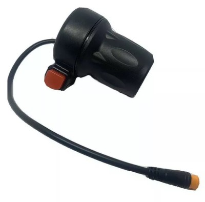

Thanks for your reponse Nealh. When I push the button in for the throttle it doesn't always work and sometimes I have to switch it on and off a few times. As the company has gone out of business I had hoped a manual on how it all works might be available somewhere online, especially as the bike is now six years old so things might start going wrong.
21,539
8,789
My be just an age /use item and needs replacing, though push button latching types probably wear might be a contact issue inside the unit. Easiest answer is probably to replace it.
21,539
8,789
If yours is the same as in the links, then the Yellow 3 pin Julet makes it simple plug and play. The Julet pin out sequence follows a set standard .
