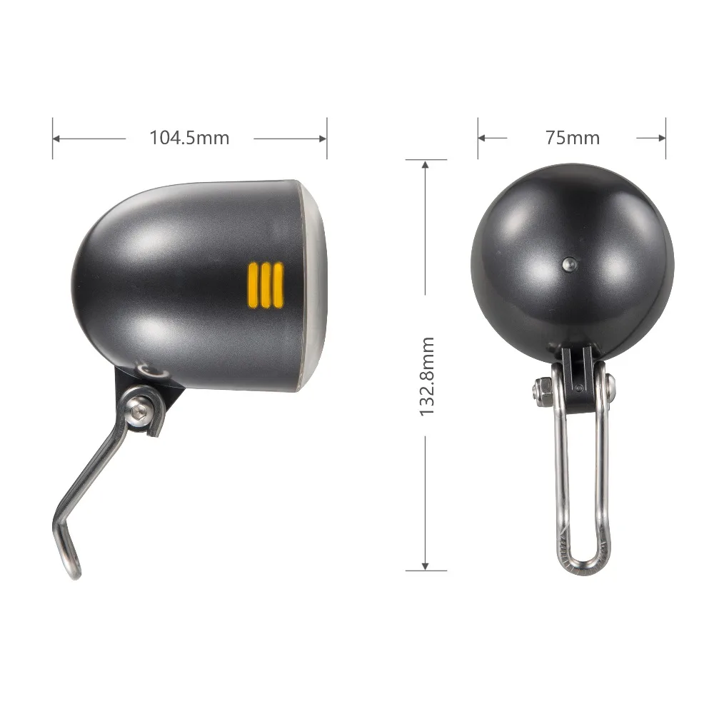

Fwiw ive opted to add this front lamp
the key feature being the 'universal input voltage' chenglish for what i understand to be a wide range of input voltages.. tho i will be running off 12v via a dc/dc converter.
not in the same league as @guerney 's solution but not needed to perform the same pothole illuminating duty as i ride in an urban generally well lit area, its making myself visible thats my primary agenda with multiple lights..
