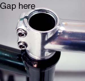

While pressing the brakes, if I push the bike forwards it doesn't feel solid, like something is loose or not set right at the front end of the bike. There's also a clunk sound if I push hard enough. I've never had a bike with front suspension or this kind of headset before, so I don't know how to isolate the problem.
As mentioned, I'm sure it wasn't like this earlier and the only thing I can think of that may have caused something to change is completely unscrewing the headset top cap bolt. The instructions I've found online and followed for adjusting this type of threadless headset (loosen the stem bolts, adjust the top cap bolt tension, then tighten the stem bolts) hasn't fixed anything. I've also tried removing the headset components (apart from the upper/lower bearings and crown race) and putting them back together exactly as they were, but this hasn't changed anything either.
