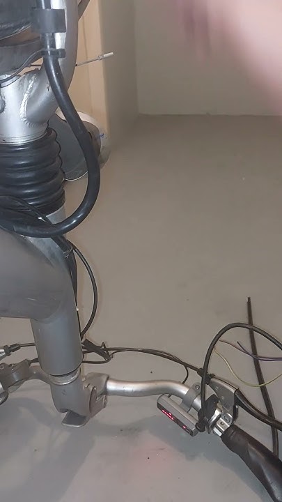

I have made a video of the problem:
Just after turning on the dysplay shows charge level.
But then it start showing the rotation of the wheel.
I have unscrewed everything and tested all wires. No broken or short cirquit wires found.
5442354424
I also opened the controller, and didn't find any visible problems:
54425
Could you suggest me what to else to check?

Just had a look at your pic of the front wheel and the fault is the damaged White cable from the controller to motor wheel connector. If you look carefully one can see in two places where the cable is damaged, in one place the cable is severly damaged and has been badly indented . One can expect internall smaller cable damage and likely broken wires and possibly shorting between them.
Repairing the cable will be messy and tricky , idealy the answer is a new wire loom with all the cables but spares might be an issue.
