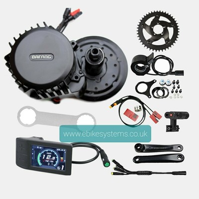

The 250w is a label, not a measure of performance. You can get very powerful 250w systems and very weak ones.
For climbing hills, you need torque, not power, though the more power you have, the faster you can climb. A tiny weak motor in a tiny wheel can get a very heavy rider up steep hills, while as a strong motor in a big wheel might struggle. It's a simple rule of mechanical advantage. If you used a motor to drive the chain or crank, the gearing becomes the key factor in climbing ability.
If you want to convert a normal bike to an ebike, look for one with disc brakes and a frame with a largish triangle. Upgrade the brakes to hydraulic ones, which gives a massive performance increase for very little cost and it only takes a few minutes to do.
