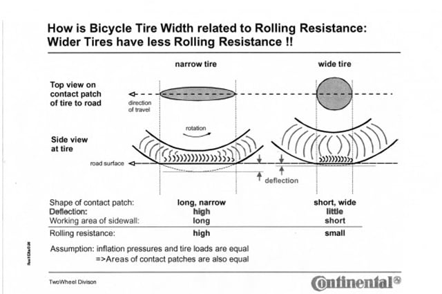

Perhaps counterintuitively it's actually the opposite - with identical types of tyre wider ones are quicker. Schwalbe have a good article on the topic here, I find Off The Beaten Path's pioneering tests and articles on the matter here good reading and Continental have a useful diagram below (their copyright):
The difference in performance betwen your bike and Saneagle's downhill will be down to other factors - if he put on 1.75s he'd be even further ahead.

Nice theory, but logic says that if that were true, everybody in the Tour de France would have 2 inch wide tyres!
And Off The Beaten Track address exactly that point in this article here! It's more than theory which is why both Schwalbe's and Continental's input is linked to in the post above, as is Off The Beaten Track's extensive testing on the matter.

I read a very good article in atob by mole (will find and paste it) about this - and why schwalbe big apples have such low rolling resistance (it has to do with the footprint being round) - and indeed they do (I've tried them, it's astonishing how easy they roll at around 15mph), but idiosyncratically I find they don't do that well at high speed - anything above twenty mph and they feel sluggish (in my experience only of course)
