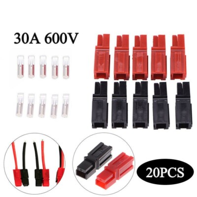

I'm also very much not a fan of the bullet connectors on the battery, and now I know everything works will be replacing with a decent automotive spec sealed 2 pin connector.

Anderson connectors are used by some, in conjunction with heatshrink tubing.

I'm going to use a Delphi Metripack connector as it's sealed as it comes and is capable of 30A. But thanks for the suggestion. I believe all the parts are available for the TDSZ2.
