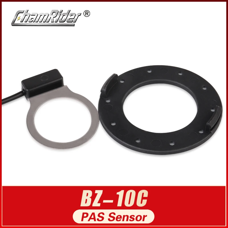

I am having a problem with the PAS, i have a hollowtech 2 bottom bracket , as you can see in the pics there is no room on the crank for it.
Any ideas?

You have the wrong PAS for hollowtech it's as simple as that.
You need a two piece PAS to fit on the RHS.
Thank you Nealh.
I will have a look at that option.

On the left side of the spindle, it is threaded internally for the plastic end cap, i have thought about finding a bolt that would be the same thread, insert that leaving the head of the bolt acting as a small extension which once filed down would allow the pedal to be clamped securely.
Any thoughts on the thread size?

I got a pal to turn me this bolt, i think this will solve the issue and allow me to clamp the crank arm securely on top of the head of the bolt. It needs to be sized down a wee bit more but when its in its solid.
