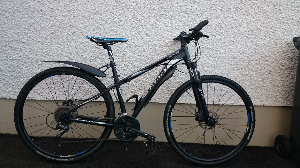

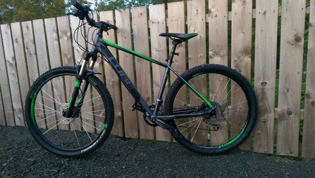

I'm looking to get a used bike, such as this or this. I can probably get something of that quality for £200ish based on my research thus far.
17,887
6,722
cube looks ok ;)
Cathal
Jan 4, 2016
56
6
36
I'm curious, what differences are there between the Cube and Giant bikes that make you choose the Cube, both look swell to me. Battery pack will blend in nicely on either of them.
17,887
6,722
cube is a mtn bike giant more for on road cube also has bigger front sus.
it just all depends what you want to use the bike for, you not want to go hard off road on a hard tail bike like the cube.
