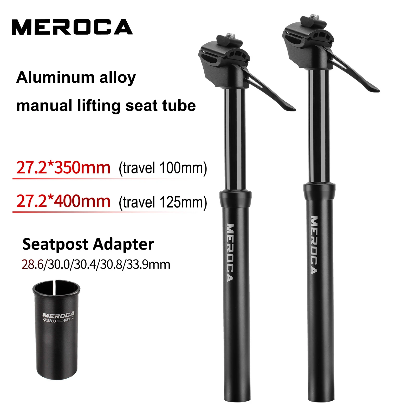

However, despite buying the same frame size I have discovered an unexpected, if slight, problem. The Forme had 700c wheels with 28 x 2.00 Schwalbe tyres which made getting a leg over the saddle when set at the correct height a bit tiresome. The Subway has 27.5" 650B wheels with 2" tyres so I was expecting it to be a bit easier to mount - but it isn't. The bottom bracket is just over an inch higher than the Forme and although I can get on and off ok, it does spoil the ride -particularly when tired.
My first thought was to swap the chainset to one with longer cranks (175mm) but this only gains 5mm pedal drop and they are eye-wateringly expensive. So how a about a dropper seatpost? I don't want to operate it mid-ride, just lower it to mount/dismount. I found lots of listings on Ali-Express for a Meroca post with a simple under-saddle lever:-
Has anyone got one of these and if so, are they any good? I won't be jumping over rocks or logs and whizzing downhill on trails that need a "proper dropper" - just gentle cycling on roads and cycle tracks.

I just ordered this one yesterday for my sister's Birthday present
Is that the same, but I think yours is a cheaper price
I looked at the internal cable routed ones, but wasn't keen on drilling her frame, and the external cable routed ones, but the collar was too big, so she wouldn't have been able to set the seat low enough
