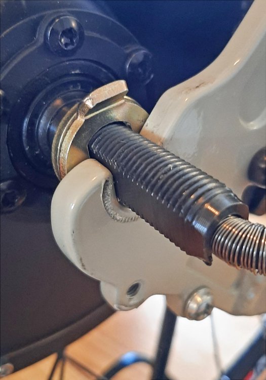

Thinking about the motor cable issue, I think your extensive experience should not be ignored, therefore I would want to have a serious chat with MiRider about that. If they showed me evidence that they had addressed that or they had ensured their motor suppliers had addressed that, it would incline me more to making a purchase. On the other hand, if all I got was a load of waffle and no real evidence, I would consider walking away.
However, for me personally this is not a huge issue because I am not a commuter, I am a fair weather recreational cyclist. So if I did purchase a GB3 I think I would keep my warranty dusted off for two years and then consider extending the motor cable and creating a proper drip-loop.
This picture from the MiRider website shows the correct cap fitted over the axle end (it was missing in the video you posted), it would do no harm to keep that fitted and maybe cram some silicone grease in there, is that something you recommend?
I'd stick a load of silicone grease in there as a belt-and-braces approach. It certainly wouldn't do any harm.
Most of the motors that I've opened didn't have anything on the inside, the cable just comes in through the axle and out through a slot in the centre. Some established brands obviously had problems with water ingress, and arranged for their Chinese colleagues to solve it by putting a blob of that white silicone rubber all round where the wire exits the axle on the inside, which is a good solution if they do it in a caring way; however, the Chines workers are often on piecework and badly trained, so their goal becomes to get a blob of silicone on that cable exit rather than to seal it. I was a quality control manager in mass production companies for 20 years, so I know how it happens.
Looking at that picture, the cable exit is almost horizontal. If that were my bike, I'd try to work a bit of extra cable backwrds through the clips so that the cable dips down more before going into the axle.
The problem is caused by the rainwater tracking down the cable and any wind helping it on its way backwards,and the water gets guided into the axle. Good practice is to have a drip loop so that the main flow will drip off before it reaches the axle. When I've built bikes with horizontal drop-outs, I always make sure that the cable exits backwards and then downwards, but that sometimes makes it get in the way the derailleur, so lots of fiddling and adjustment to get it right. You can see the problem and best solution in this photo of a bike I built back nine years ago for a guy that only had one working leg. You have to zoom in a bit to get the detail:
