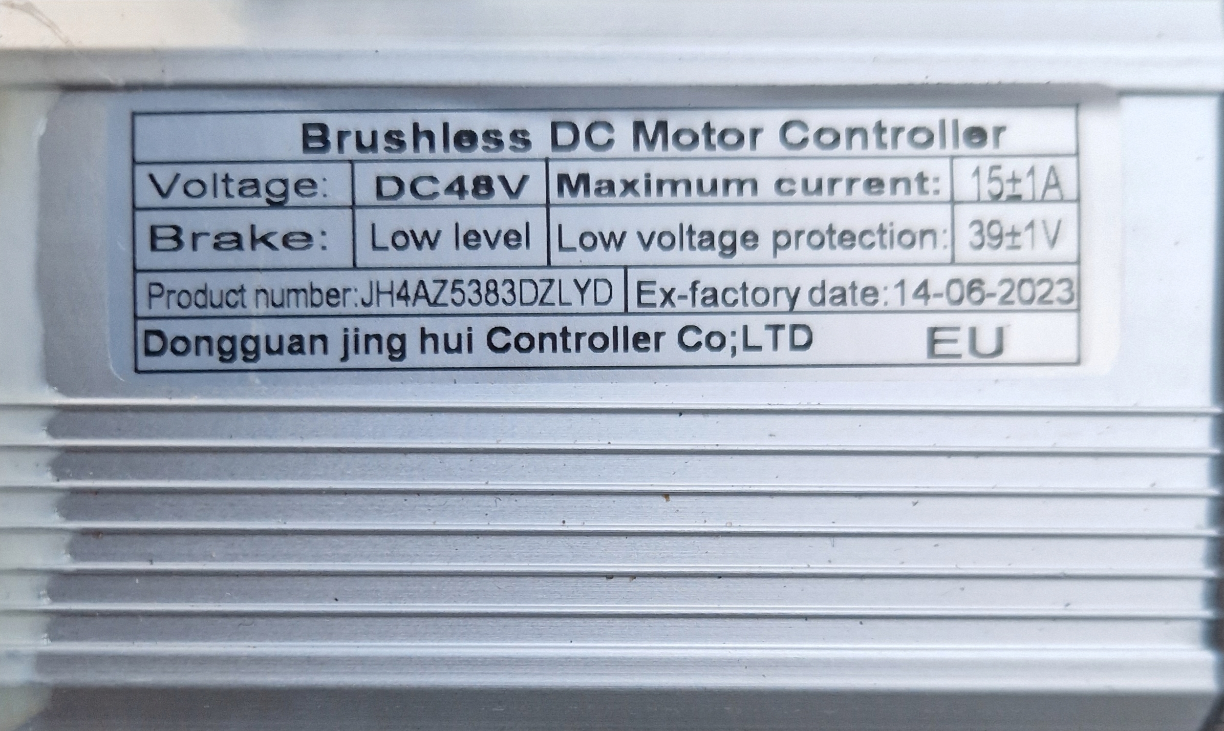

İ tried 1000uf 63v capacitor no change at all. should i change the capacitor inside of the controller? Has 3 of 470uf 100v capacitor i can change all of them to 63v 1000uf. 53546
53547

No, I don't think you can do any more with capacitors. it was just an idea. Your controller already has about the biggest capacitors I've seen in one that size. Just one thought: You did connect the 63v 1000uf one the correct way round?
I'm out of ideas now. I don't think it's a hall problem because it runs OK at low power. Power doesn't affect the halls. They're on an independent circuit.
