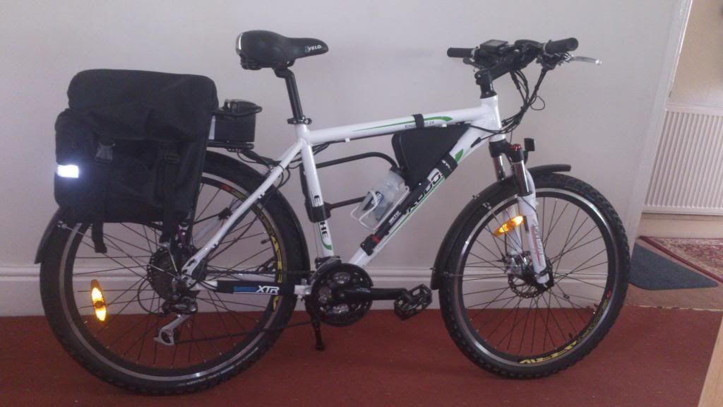

Could anyone tell me where i could get some flaps for the end of these mudguards ? Not huge ones , enough to catch more spray form front mostly .
Thanks
Rob

I make mudflaps from the leg of an old wellington boot. I have also used the plastic from a one gallon oil bottle. By making your own, you can get whatever size you want. I drill the mudguard, and use small nuts and bolts for attachment. Temporarily put a bit of wood between mudguard and tyre to avoid drilling the tyre.

Personally, I'd go with the SKS flap linked to by Jonah. I use that mud flap and it works very well and fits neatly onto the mudguard. Your bike looks nice, and bits of old Wellington boot attached to it may spoil the appearance. It's worth £3.99 to keep it looking presentable.
cheers i think ill go with jonah to , £3.99 is reasonable
