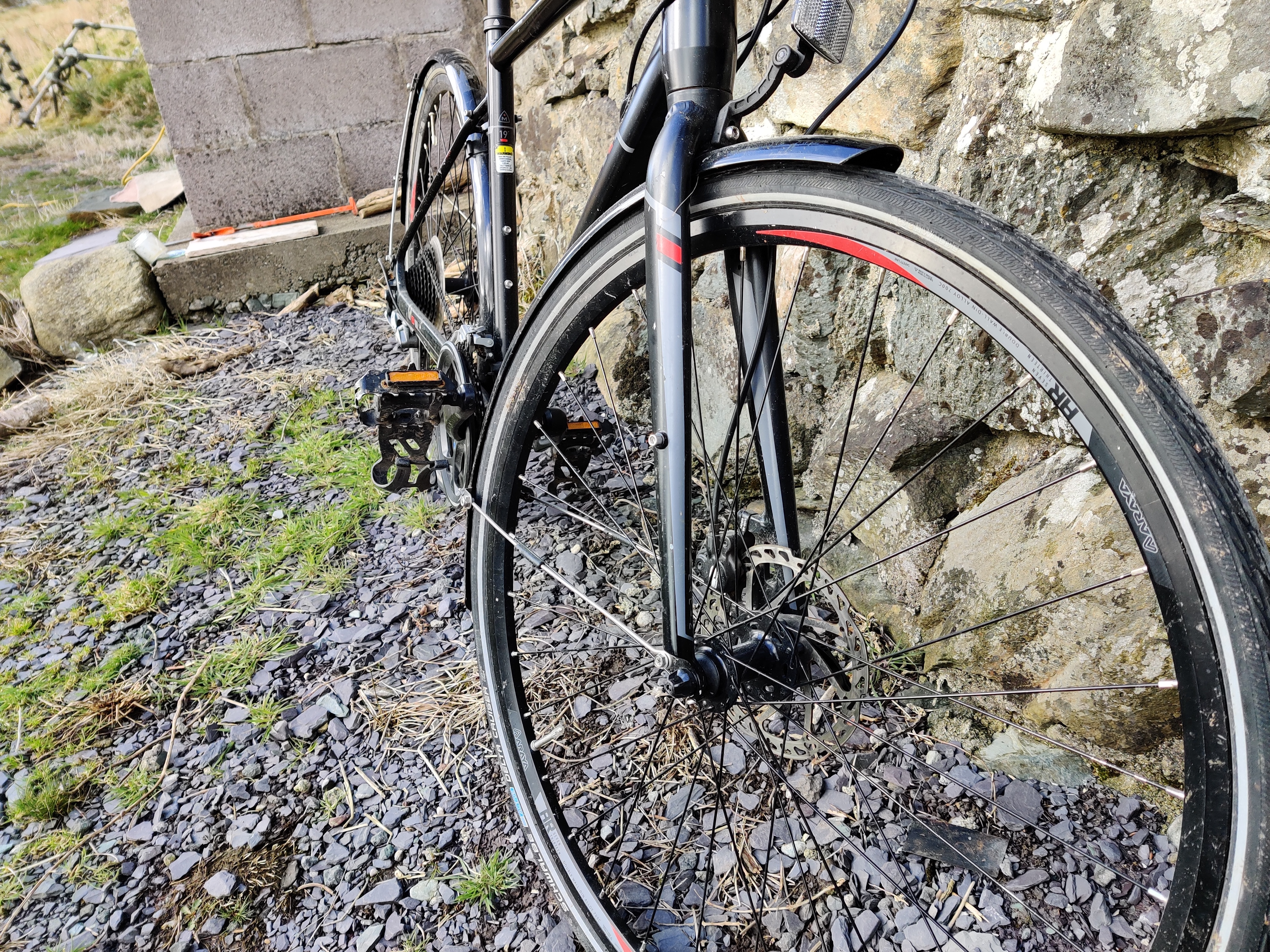

Help! My Toba Beatbike stepthrough, about 3 years old, and the seat tube has developed a crack

The crack is right at the bottom end of the seat tube, just above the weld where the seat tube connects to the motor housing - you can see it just below the white tape. Even if the motor and the battery mount were removed, I suspect it would be difficult to weld the tube back to full strength, but does anyone have any suggestions, please?
Pity, the bike itself is great, with no battery or motor problems at all, such a shame to have to think of selling it for spares or breaking it up

Source a good Welder to grind out the crack and put a gusset between the seat tube and the horizontal tube . Steel would be easier to fix than Aluminium though .

That looks pretty well terminal. The only thing I can suggest is to drop the motor out, cut a but of tube off a spare seatpin and epoxy it inside . It's a weird place to break because I wouldn't have expected there to be the sort off stresses that would cause it. I can't see that it would be much of a problem if the crack completely detaches the tube, which it probably already has.

I’m 6’4” and about 105 kgs, and it is a stepthrough frame, so perhaps it was too much stress - a diamond frame is perhaps a bit stronger.

Although the electronics of the bike are out of warranty speak with the dealer as often the frame it self may have a 5 or 10 year warranty, if the bike was supplied by 50c then you are out.
Ok, that's different. I assumed it was a crossbar type. I can now understand how it cracked. In that case you can't use the epoxy tube repair. You'd have to strip it down and get it properly welded unless you can get a new frame from somewhere. frames are usually guaranteed for a long time, but if you got it from 50cycles, you're out.

Sadly IMO it would stand no chance, and sadly even if a welding repair was made it would be short lived unless the frame was re stress relieved, all getting expensive because of the collateral work needed.

Being a retired welder I would say it's terminal and certainly don't think about repair putty

Thanks all, I think Gliggsy may be right, so I think I’ll try an advert on here as “spares or repair”, someone out there may be wanting to replace their Impulse motor, battery, forks, wheels or Nexus 7 hub - worth a try, anyway, thanks again for all of your advice and comments
