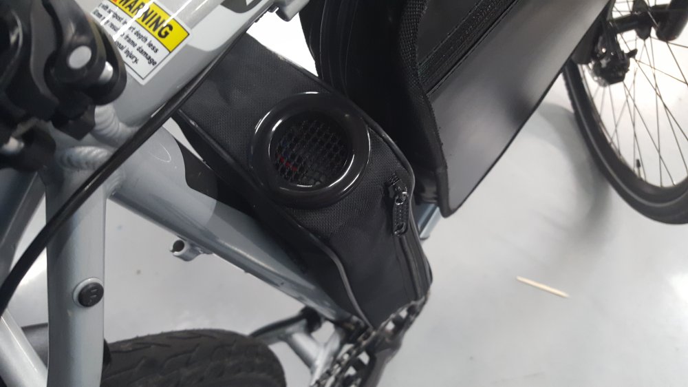

Hi thanks for your message I've posted a picture of my bike and controller. Its a brushless motor, battery is 36v 10ah lithium-ion.

What device is on the handle bars to control the assist levels if you don't know show a pic of the bars.
