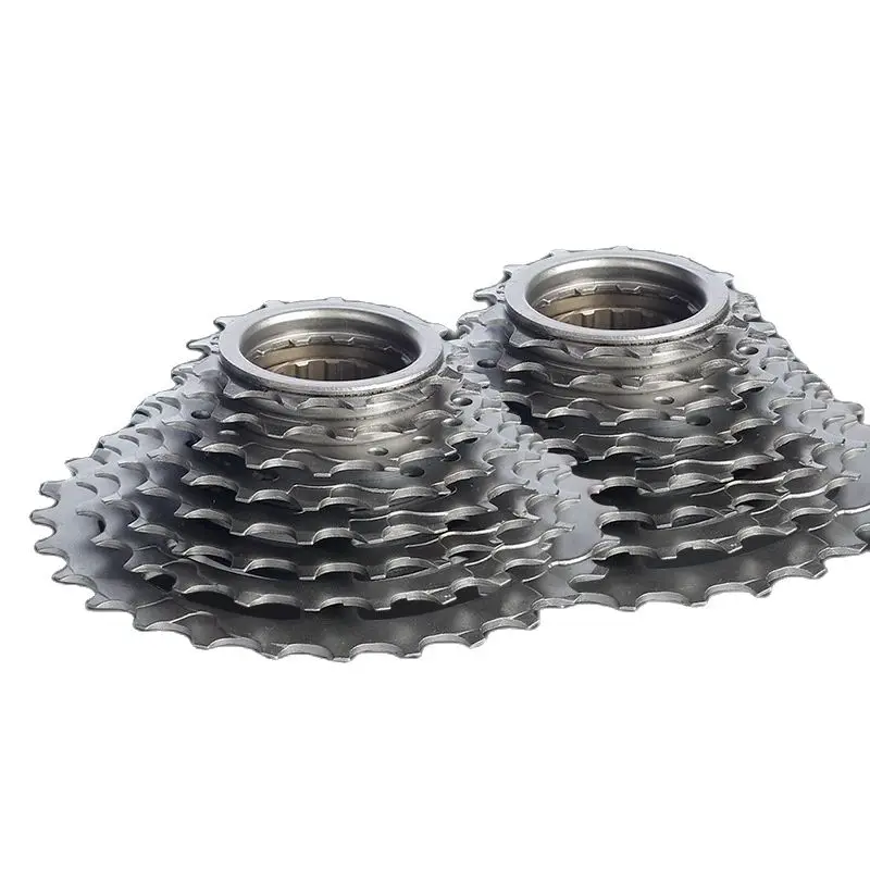

I think the difference on the freewheels is the number of teeth on the top gear (smallest cog nearest you). The troublesome ones have 11 teeth and the later ones have 14 teeth. You can still get the problem on the later ones, but not so frequent.
This is the freewheel. If you look at the hole in the centre, you can see a sort of brownish band inside. that's where the oil has to go in but the axle and frame will get in the way.

Your problem appears to be not with the electric side of the bike but the rear wheel hub part known as the 'freehub' - this is the bit the derailleur gear sprockets attach to.
Within the freehub is a system that allows you to free-wheel (not pedal) when rolling along - a sort of ratchet system (the pawls as referred to by @saneagle ) - if they get rusty, the pawls refuse to engage, something that needs to happen to enable you to pedal, hence it looks like the pawls need lubrication to free them up.
