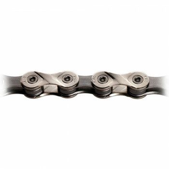

Looks like you already have a long cage derailleur, so you'll just need a longer chain to go with the above cassette, a KMC 9 speed 116 link should do it (remove links if too long when fitting), those are about £15
