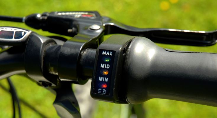

Mike,
this is the Conv-E:
The motor cable has 3 pins, the green socket accepts a twist throttle and on/off switch:
you need that twist throttle, you can't use the kit without it.
The yellow socket accepts a pedal sensor. You may be able to buy something similar on ebay.
You should post lots of pictures of your kit here, some members may be able to help.
