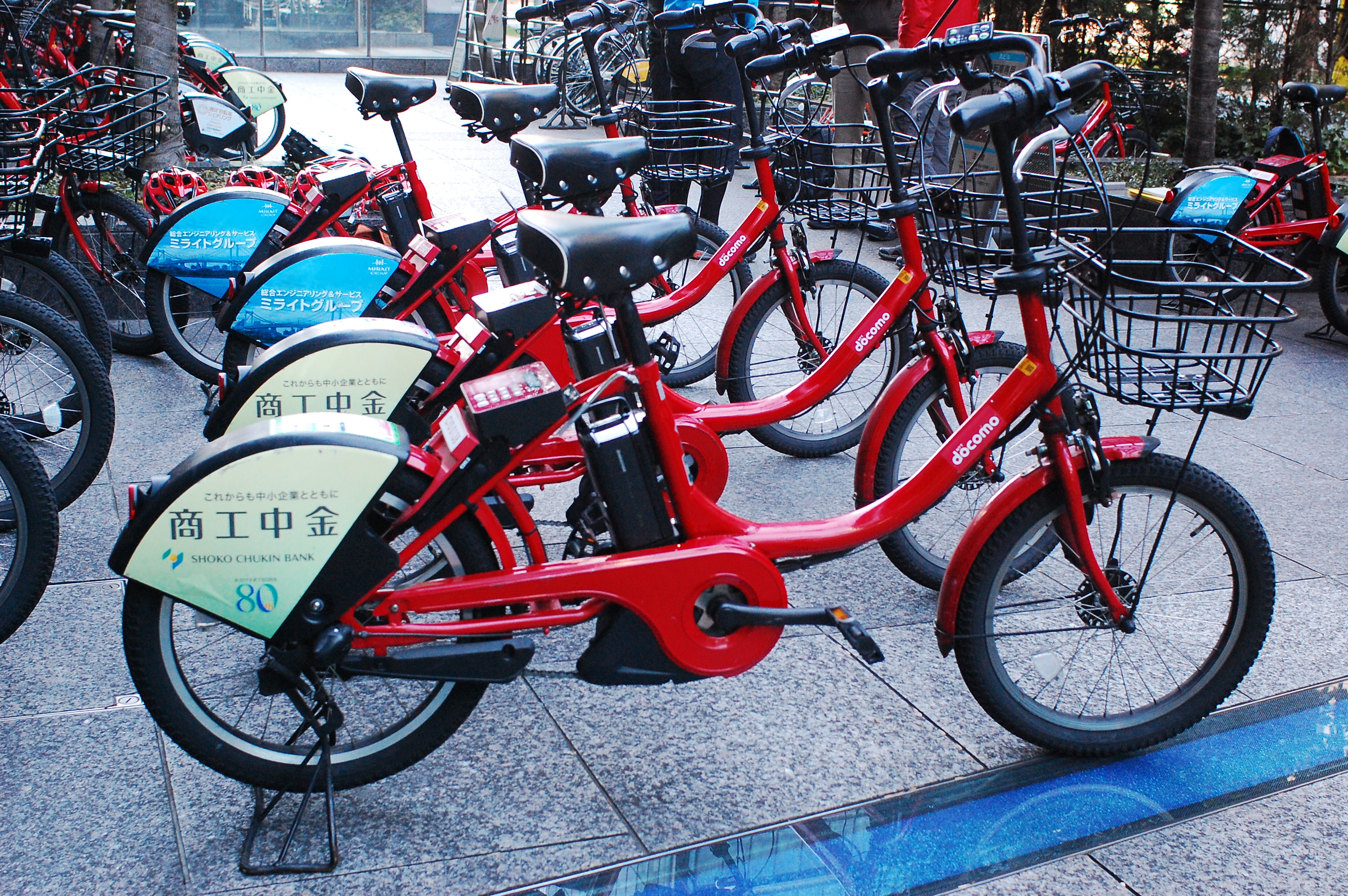

Our first ebike experience was in Tokyo on these:
Although it was comically small for me it was still fantastic way to get around and awesome fun to boot.
