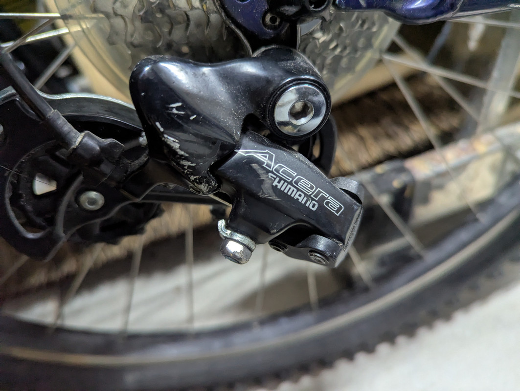

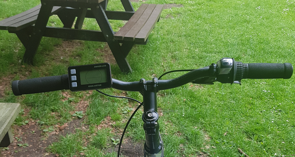

I have a rear wheel with an 8 speed cassette.
My problem is the combined v-brake and shifter which I've now removed.
I'm fitting hydraulic brakes with hub cut-off sensors so I'm going to now need a 8-speed shifter to match my derailleur. I'm not sure what I need to buy. Can I buy any 8-speed shifter or do I need a specific one to match a cassette?
My current bike derailleur is a Shimano Acera.

You need something that matches, because the indexing is in the shifter and the distance moved each shift is determined by it and the derailleur together.
You'll find compatibility tables online in many places but including the Shimano website, and 8 speed stuff is fairly cheap, and often turns up slightly used on eBay. Make sure you include 8 speed in the search.

Any Shimano 8 speed shifter will work with your derailleur. it's a shame you're too late now, but you could have got one of the Shimano combined hydraulic brake shifters, which are really good. I try to fit them on all my bikes. they're normally around £50 a pair, but sometimes £40, and I just snagged these for £30. One lever is broken, but I only need the hose and caliper on that side.
