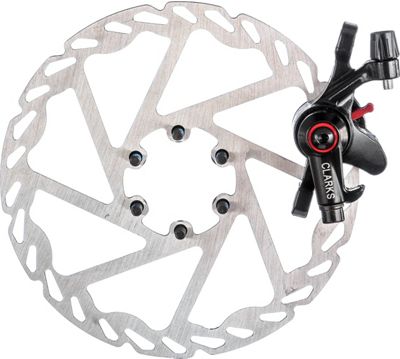

Hello Donna,
Check first if one of the brake pads touches the rotor.
If your husband wants to replace the brakes, choose something like this to replace with, they cost about £10 and are widely available at any local bike shop including Halfords:

the Clarke cable operated brakes lets you keep the sensored brake levers. If your husband upgrade the brakes to hydraulic, he should also fit hydraulic brake sensors to stop the motor overrun when you turn or slow down.
