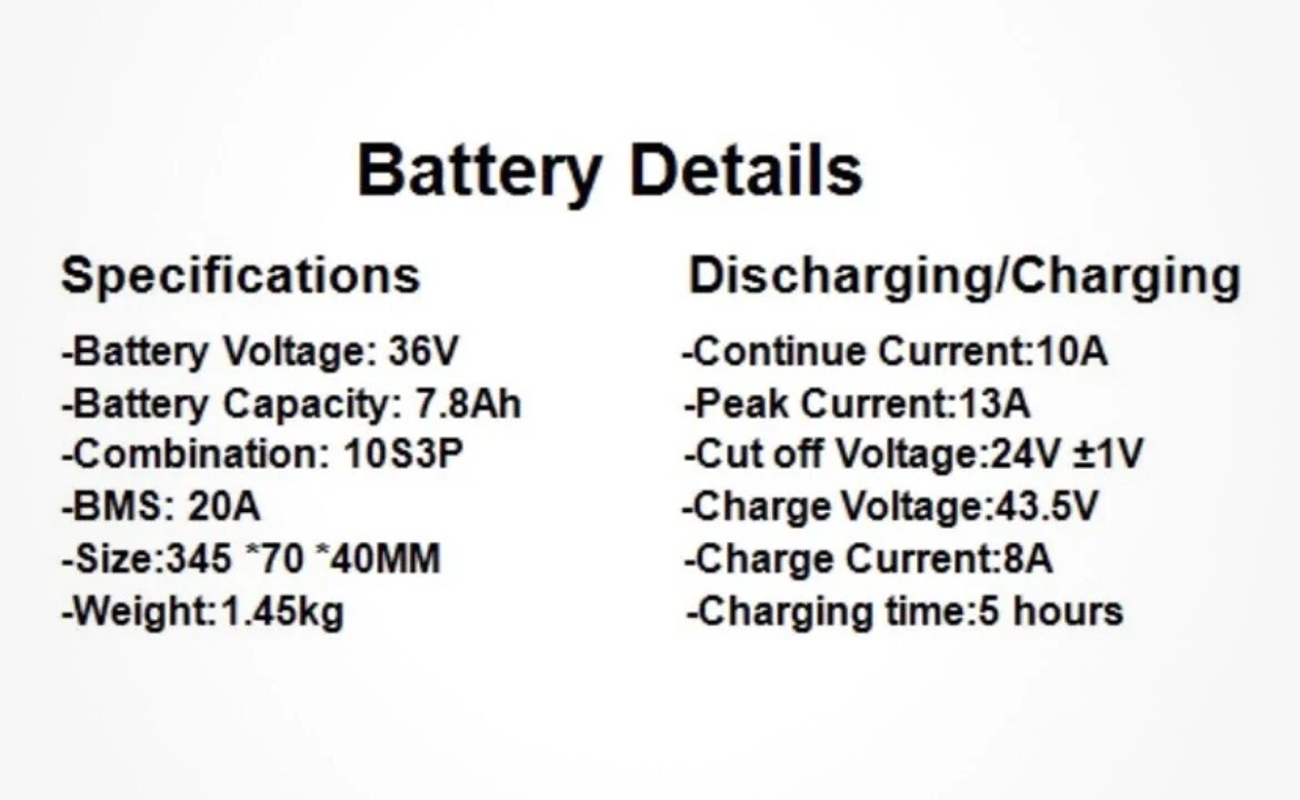

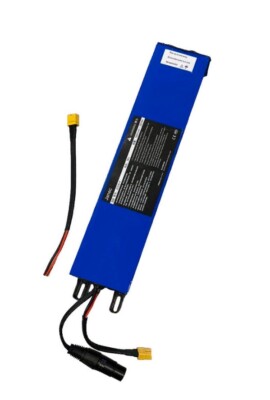

With my 2A charger, I won't get much mileage from a 1 hour charge. Do they tow your EV/microEV away after 2 hours? Then charge you a release fee plus £0.57 per kWh? They forbid use of chargepoint for more than an hour, but also forbid returning until after 2 hours? I may need a translator.
How far apart can these Chargepoints be in Scotland? 40 miles? Are we limited to 13A, if we use the plug adapter linked above? Even if I thought charging three of these cheapo 7.8Ah "LITHIUM-IRON" batteries with three 8A chargers was a sensible and safe activity to be engaged in (without an iron), I couldn't attempt to do so without using three chargepoints simultaneously for an hour, or three 1 hour chargepoint sessions at the same chargepoint:
https://chargeplacescotland.org/wp-content/uploads/2018/09/cps-etiquette-guide.pdf
Am I liable if one of these battery packs goes up in flames and destroys the Chargepoint? If not, I might give this ago. What puts me off is Scottish midges.
Would fast charging make much difference?
Fast charging those battery packs at 8A will make a big difference in temperature :eek:
