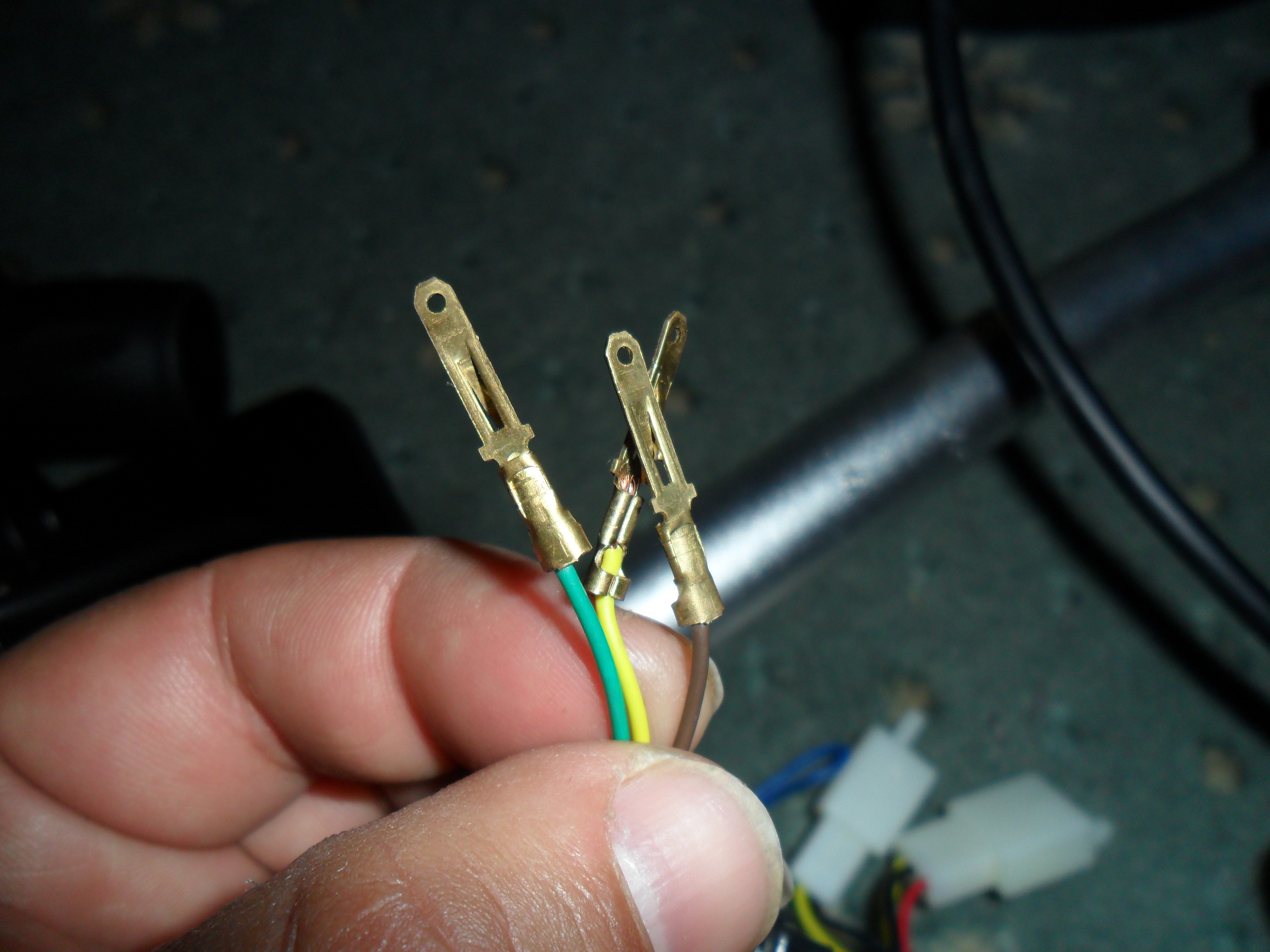

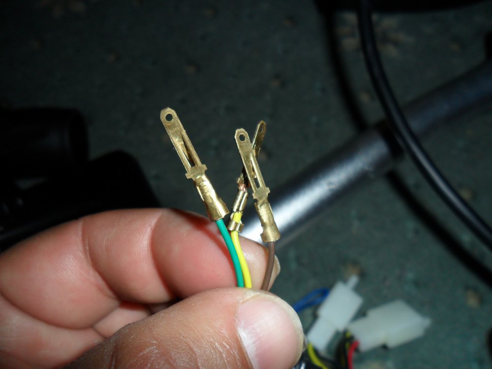

  7. I disconnected the throttle ,all the wires in the motor match each other ,and there is no error now ,so looks like something is wrong with the throttle. The colours on the connector in the throttle don't match the connector in the controller ,the throttle has red, black and white, apart of other three loose cables with green, brown and yellow ,I guess that the last three are for the battery charge indicator, but in the controller, if I follow the diagram , the connector are red, black and blue.
