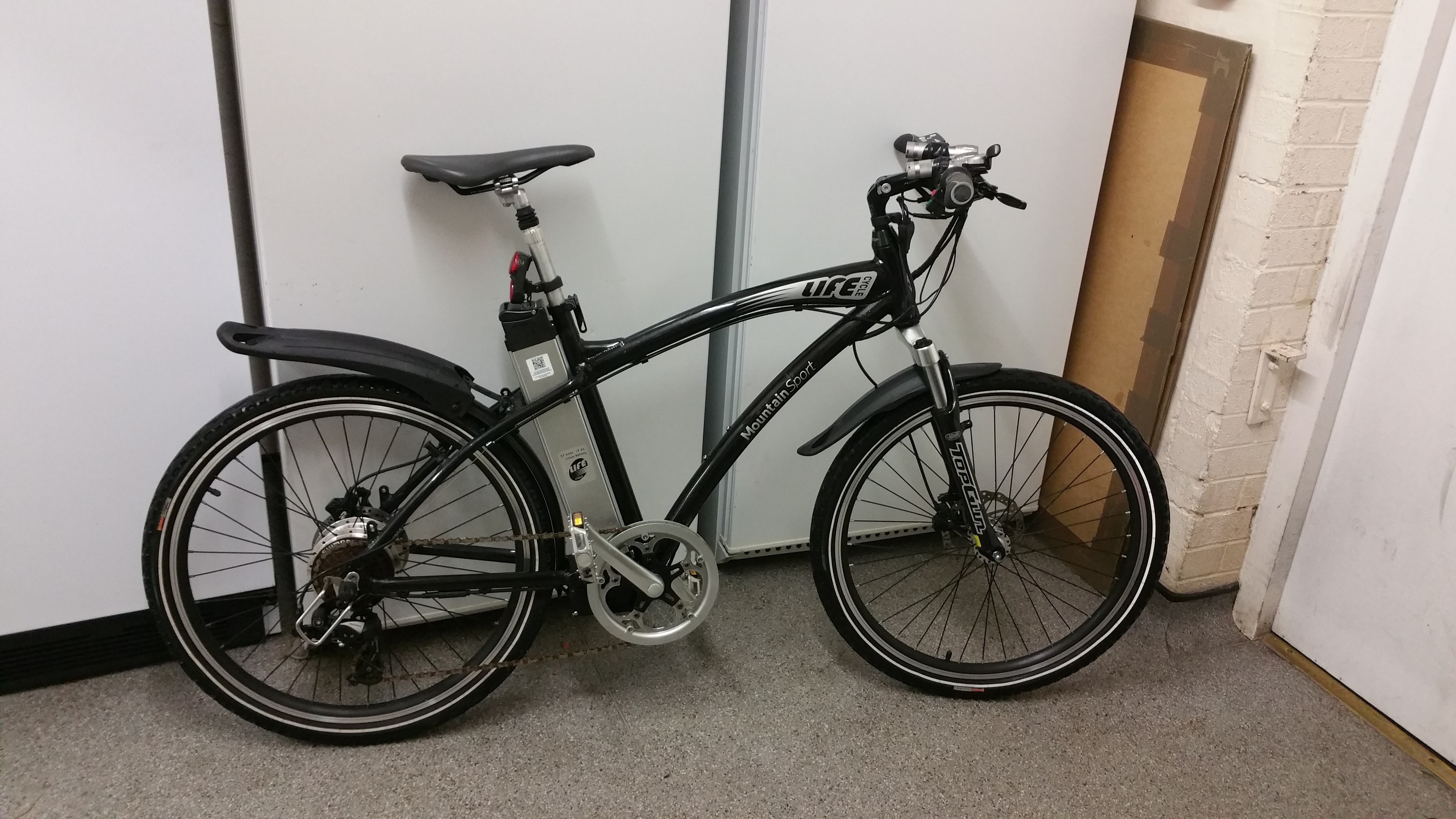

  6. I'm glad I asked. I ended up cleaning it at work and using a full blue roll to do so. It just gets bad round where the battery sits. Here is what it looks like if anyone is interested.
  7. Are these bikes ok to jet wash as long as I miss the Controller and take off the battery? Or will it screw up the motor or something?
