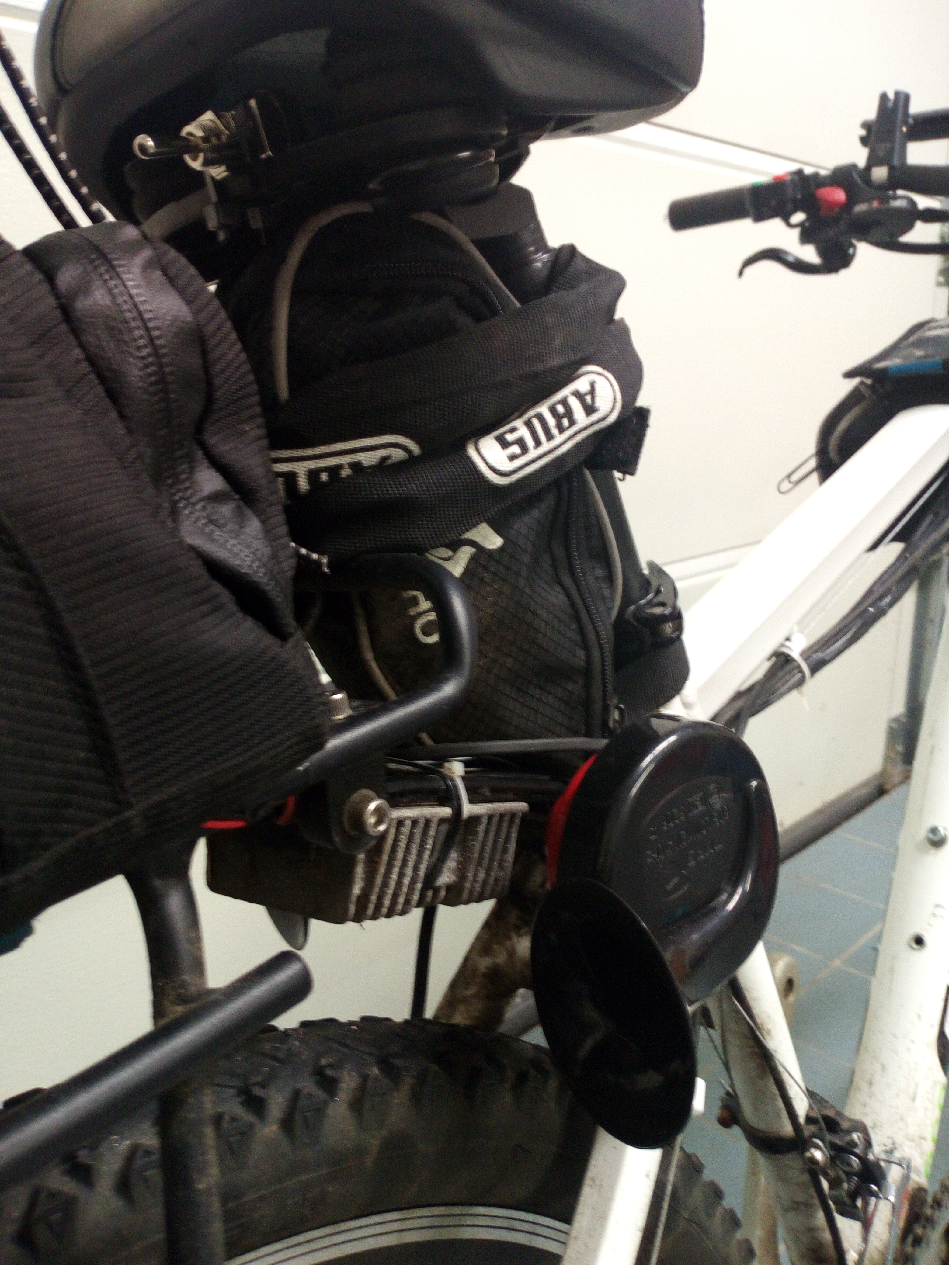

  2. I ordered a pair of snail, dual air horns for £6. Nothing poxy about them! 100+ dB. In the photo you'll also notice on/off switch at back of saddle, also horn and indicator control on handlebars. The bag on the cross bar contains the wiring and is a phone holder as well. Use Strava for speedometer and distance covered. Wiring still a work in progress.
