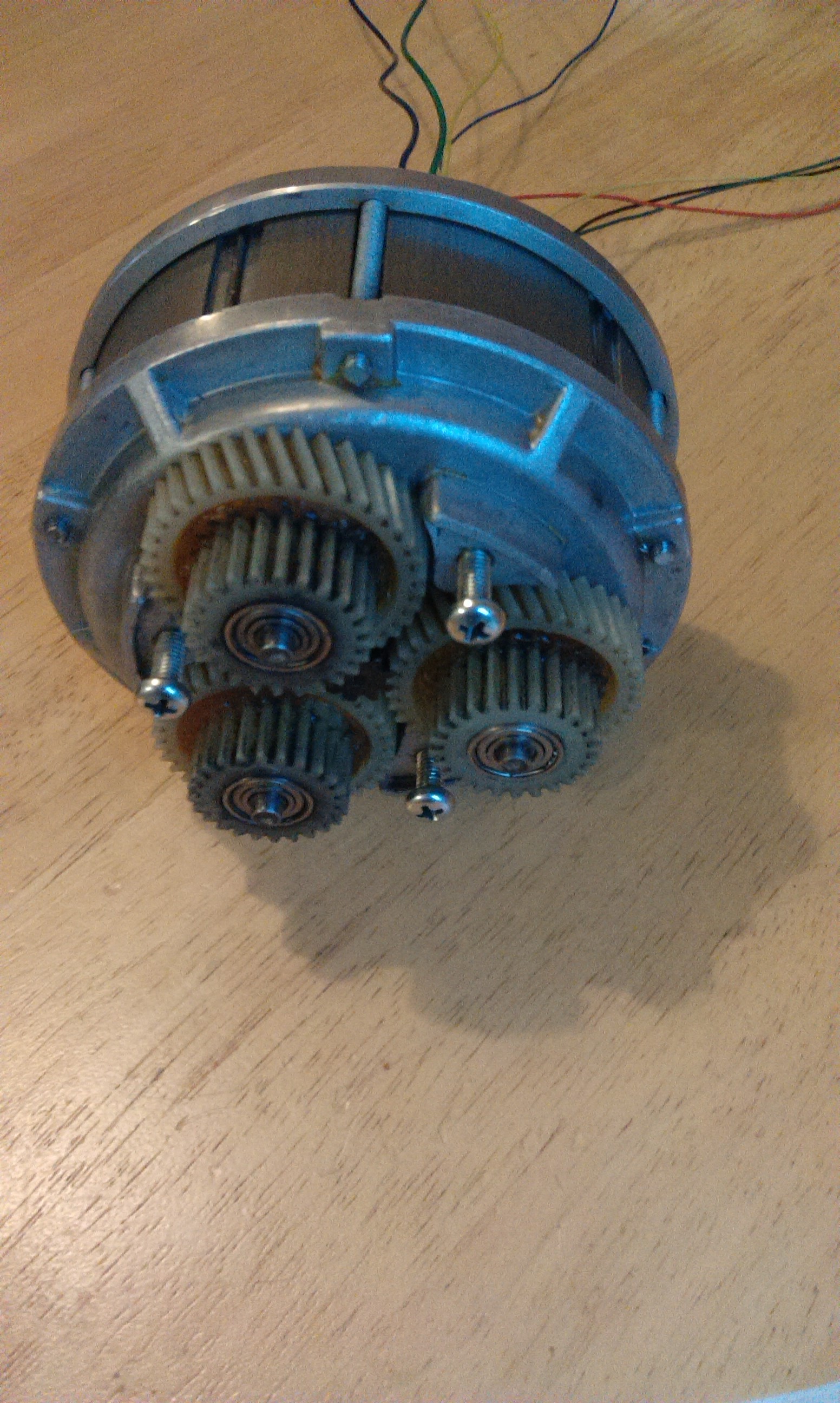

  3. Hi guy's I've got a problem with my electric bike setup. My geared hub motor and controller get warm to touch? Battery is a 24v 28ah li-ion with a 24v 15a controller I brought from panda on the internet and a Chinese geared hub motor that is 24v 180a. will try and upload some picks soon any advice please

  5. Am not sure I know it is an import and has no brand on it but I know it is à 24v 200w geared hub motor?
