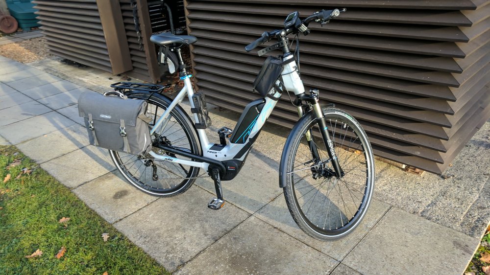

  2. I did something very similar last winter - wet stuff turned to black stuff. I also hit the side of my helmeted head as the bike went over so quickly. Now I will lower tyre pressures and saddle, and have some winter tyres to put on too. Plus you can get Endura pants with padded hips. This was in 4 degrees but in sheltered areas e.g. between trees and hedges with no sun it can still be icy. I hope you fully recover soon! (see about 55secs in) :
  3. I've just got myself a 2017 KTM Macina Tour (to replace a dud Kalkhoff Agattu Impulse). I couldn't find much chat about them online before I bought it, so any questions please ask. Although it is the 2017, they seem to have made very minor changes with the 2018 model. I'm 5'10 and this is the large size, which fits very well and still feels 'compact' and corners sharply. It is excellent up hills (better than the Impulse) but is slightly more bobbly around the top end 15-16mph mark (i.e. the speed moves around that mark rather than sitting dead on it as with the Impulse). It is also not as noisy as online videos make out - I would say it is a high quality reassuringly technological electronic whirring sound. The front suspension is great and the seat post suspension is also working well. It's my first time with disc brakes - I still don't see a great advantage - and also first time with a derailleur on an ebike. I'd have preferred another hub geared bike but a) the torque is reduced by Bosch for hub geared models b) I still don't trust innovations like Nuvinci. Videos you see online of derailleur changes on ebikes always sound very painful, but it's not quite as bad in practice. 10 gears is probably one too many (I can't see a use for the highest gear) and with four modes, that is also probably one too many. Tour mode is good for the commute, with Turbo for hills. I don't see the point of the mode in between which is 'Sport', and I think you'd only use the Economy mode if you were running low on battery and needed to get home. I forgot to put the battery back on it the other day, and tried it under my own steam, it was pretty easy to ride. The motor power level display part of trees handlebar display is quite small, and the push buttons to change mode don't light up in the dark as with the previous Agattu. The pedals are nice and tight to the frame (I found my feet were very wide apart with the Impulse) but that creates a problem as the chain stays are very splayed out, so I'm catching my heel on them when I pedal. I'm sure I'll get used to avoiding this, if not, I'll see if different medals work better. All the ancillaries - lights, mudguards, saddle, handlebars, rack, stand etc - all seem great so far.
