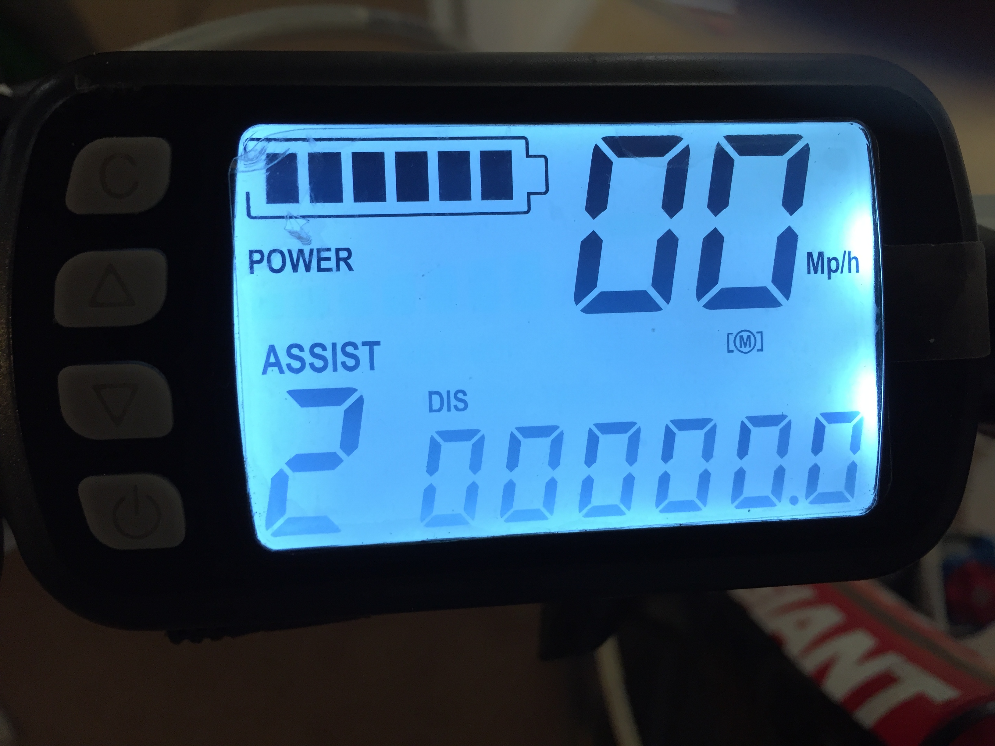

Final update - After the first controller went missing I have finally received the new controller and it has solved the problem Overall very happy with Dillinger and the service I have received

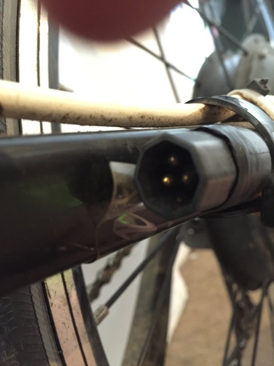

Ok ignore the last, they have just replied reply - It is possible that the hall sensor could have burnt out causing a short, but from our experience the motor is the most reliable part of the system. The first step though in our experience is to replace the controller. Fingers crossed this will solve the problem and wont take too long. Am hating being without my bike already. Will definitely be buying spares for the future! Will keep updating as I'm sure they are a possible source for many of the people who come across this. Even though none of you seem interested

As some of you may have read I purchased a kit from Dillenger around 4 months ago. While on a ride yesterday my bike developed what started as an intermittent fault but turned into full failure before I got home. The bike has stopped working and shows a (m) error on the display. After unplugging and plugging in all the connections it will spin the wheel intermittently, but when it comes to moving the bike it fails and shows the error and wont move the bike. While trying to diagnose the problem I have found that the 3 pin connector from the controller to the motor seems to have melted the plastic at the top of where 2 of the prongs go into the holes. It also confirms it has been getting warm because the plastic cover on the frame seems to have been affected by heat and the plug with the prongs seems slightly mis-shapen on the exterior. I sent an email off to their support department yesterday, who have suggested it may be a case of sending replacement cables to sort, although considering they're wired into the motor and controller I'm not quite sure how that's going to work. Currently stuck for transport so if anyone has any suggestions as to what would be at fault or what replacement bits I could purchase in the meantime to keep me going I would be very grateful. Will keep you updated as to how it goes as I know some of you were curious as to their customer service and how they deal with problems. Also to note while I was trying to get home I phoned customer support for advice on the error, and there was no information for this display, unfortunately she wasn't able to find it on there system. Which was a bit disheartening. Anybody know anything about which display its using and what the fault code could mean? to me (m) in a circle suggests motor, although I expected the hub motor to be the most reliable part. Thanks for any advice you can give
