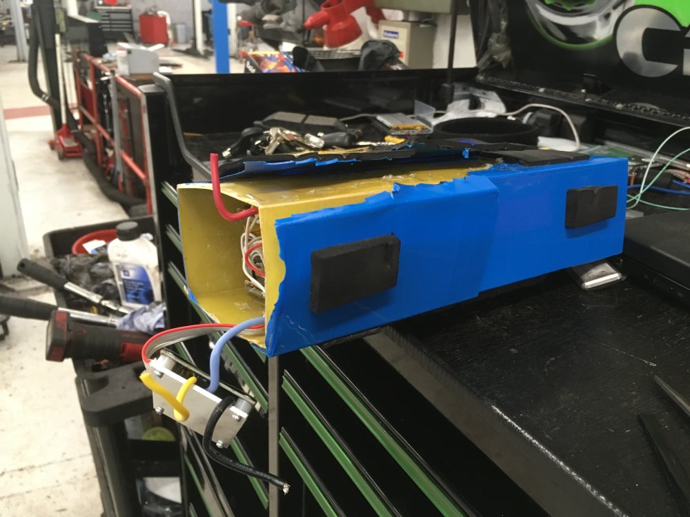

  1. Built and currently going through charge and discharge test cycles.
  2. Quick update guys, my old battery case and charger is been shipped to Otas and he's in the process of building the battery with modern more powerful Panasonic NCR18650PF cells (50 OF THE LITTLE BEASTS) Waiting patiently now for Otas to build and throughly test before shipping. Cant wait to try it out. Exciting times
  3. I think there will be space as the original battery was wrapped in a lot of soft rubber foam, I'll take the case into work tomorrow and take some measurements. Other thing is will I be able to charge it using my existing charger? I think it charges at 42v 2amps. If I send you the case will you assemble everything in it for me? I noticed when I was taking the case apart the didn't even use the 20amp fuse that is accessible from the outside!. I'm new here so I'll send you a private message if I can with my number and will sort it from there.

  5. Ooh that looks like an expensive bike, treating you good so far? how long have you had it? Any issues?
