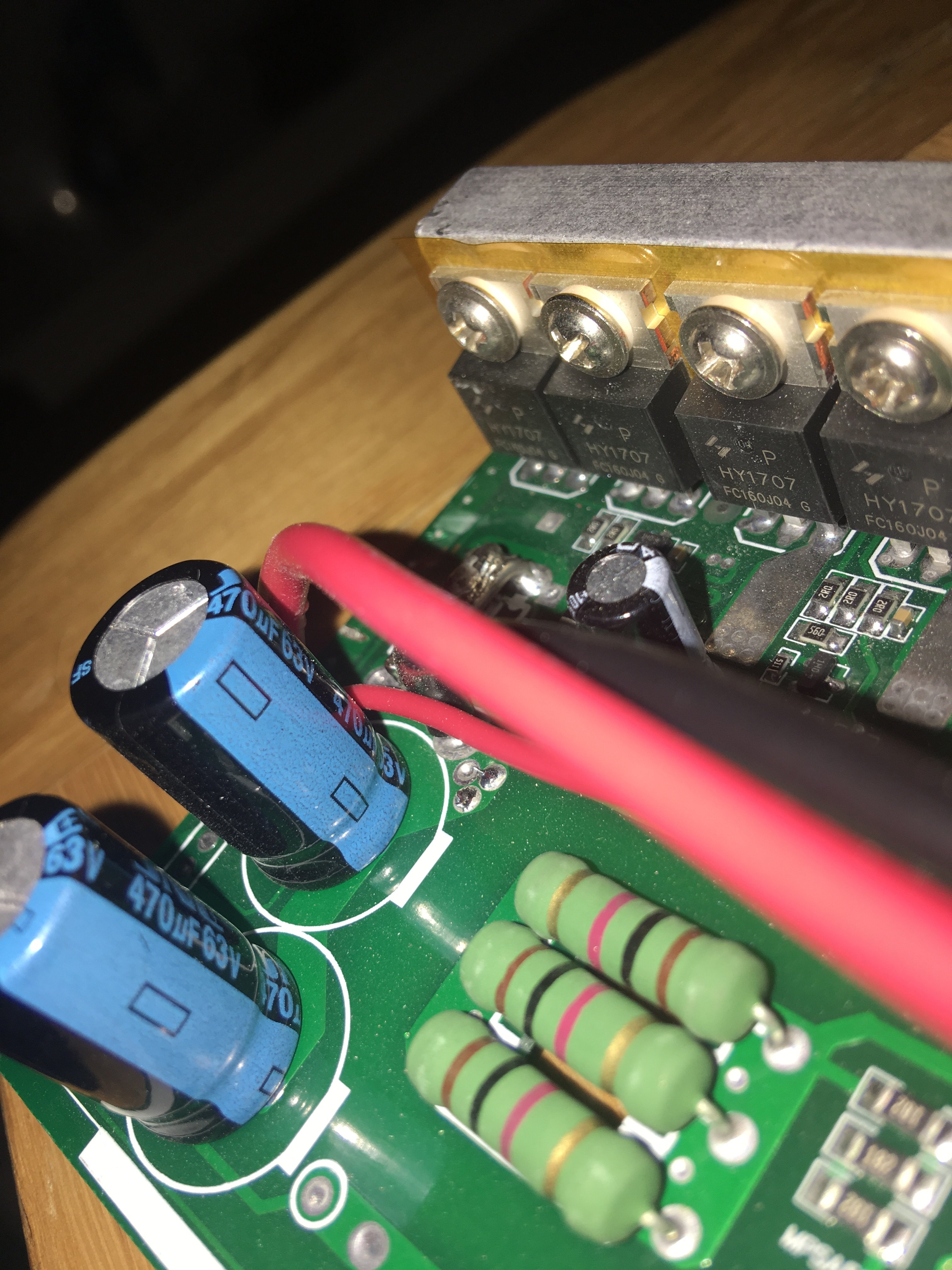

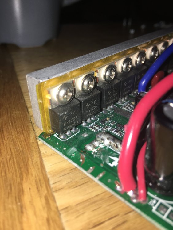

  1. Hello guys need some advice I have a couple 48v controllers lying around and want to feel the performance of 72v before I fork out on a £££+ Sabvaton and £££ on a qs205 I have what looks like a well built 15 fet controller can anyone identify it and give advice on what caps/fets are the best It has survived 100A bursts without warming too much so I hope for 72v 50A but don't mind if it dies after a few uses I got it free with a motor kit that turned out to be a solid kit compared to newer ones I have come across

  5. Will use it to adjust more, it began cutting out again so i tested stalling the motor on highest setting after cutting one of the shunts off And it was fine even under stall, then after a short ride it was cutting out again and not cuts out when stalling. It seems the shunt trick works but after a bit of driving the controller is slowly increasing the power?

  8. So had a read around and seen another of your posts mentioning you shaved the shunts. So googling found out what a shunt is. Located mine and shaved (20% of the shunt) hoping for 25>> 20 Resistance before shaving was around 3ohms after was 4.5 so i shaved abit too much maybe but the readings were not very reliable anyway. So i test by holding break and pushing full throttle the bike nearly shot through my neighbours bedroom wall!! How reducing the Amps results in such crazy power gain i am unsure. However it now hasnt cut out i will test it out and hopefully it stays working Thank you for the help
  9. http://imgbox.com/kKQtxygK
  10. http://imgbox.com/kKQtxygK http://imgbox.com/Bhq1tuWI http://imgbox.com/KVfbR0FM http://imgbox.com/Ja5jzZGO
