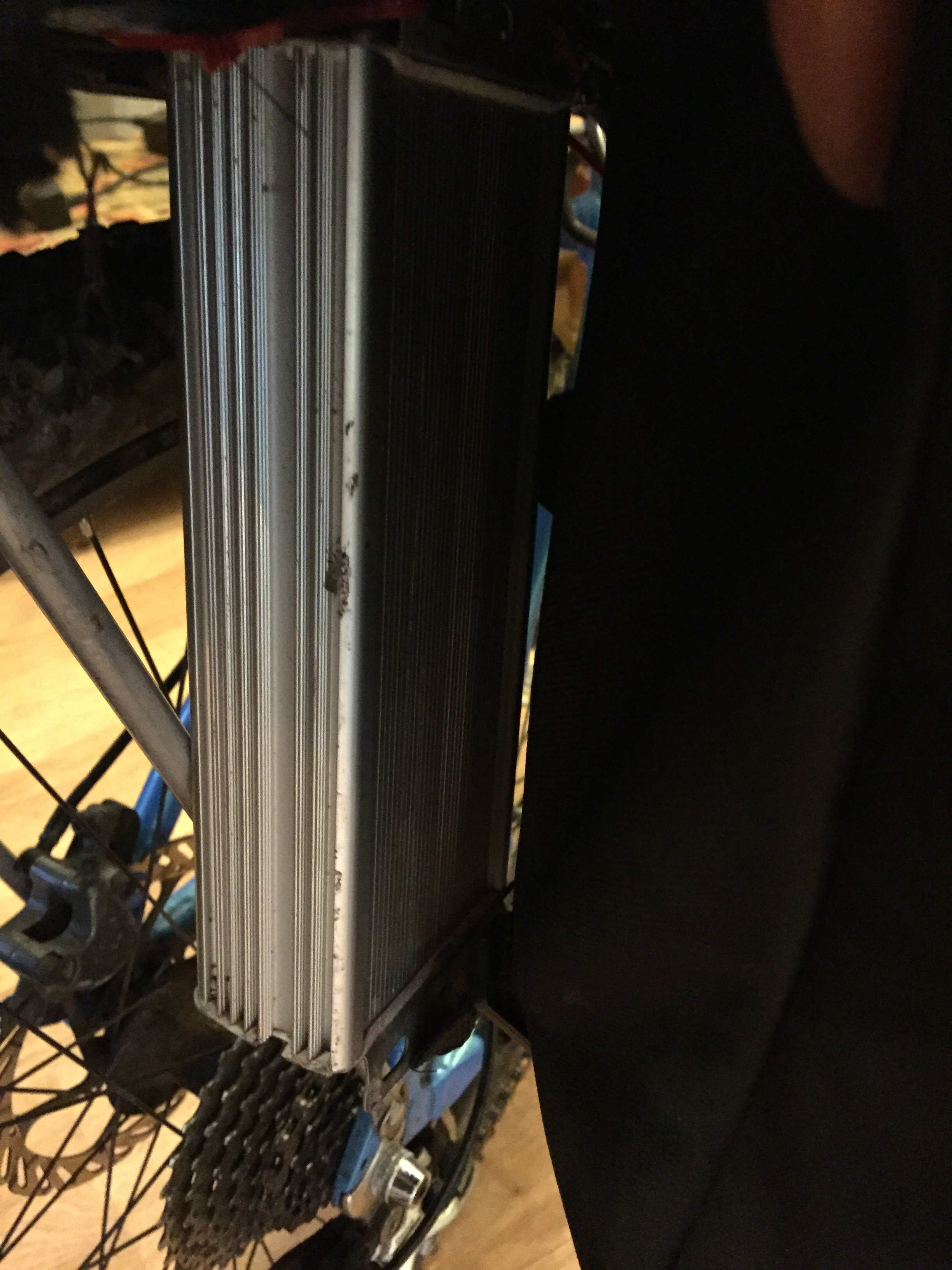

  8. There's only one controller, I meant the other silver box is the battery. So, apart from the torque arms, how else can I make this better, especially in the hills?
  9. On the flat, it's fast! On the hills, it nearly stops... So why two silver boxes?

  12. Ok, I have this set up...
