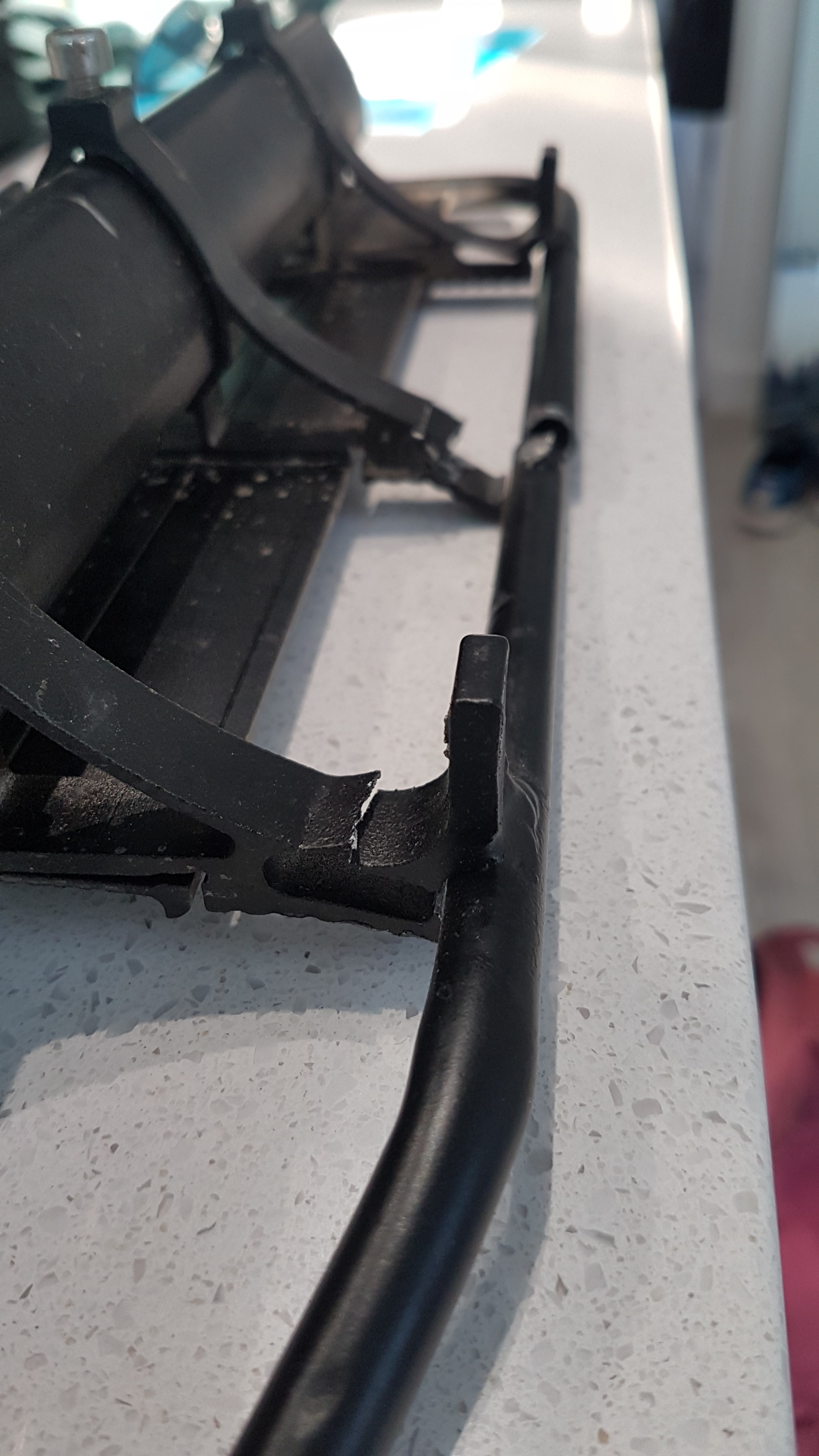

  15. Update: The replacement battery has failed. I was riding home from work yesterday and it literally just died on me, as if I switched the bike off. The battery was running at about 25% at the time and after that the bike would not power up again. I fully charged it later and put it on the bike and the same issue. If I put the original battery on the bike starts up no problem so it looks like the unit has failed in some way. I will be in touch with the supplier today to see what they say [They are collecting it Monday and will be testing it to see what the fault is]. The back rack I bought to carry the spare battery and charger is going back today as well. It is literally falling apart (the blurry bracket in the middle broke completely a few weeks back, which I knew about, the one in the foreground is also on the way as is the middle one on the other side...both of which I didnt know about until I took it off yesterday)
