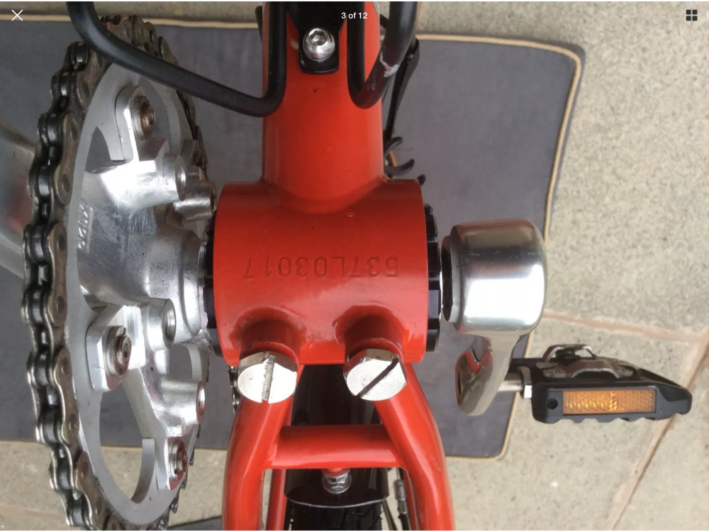

  1. Any thoughts on whether a mid drive could be mounted on to my bike ? Also can the xiongda 2 speed be bought in Europe as a kit ? Thanks again M
  2. Photos are from eBay but show the same model as my bike and show how the eccentric BB is tightened up

  6. Thanks for the links. Am I right in thinking I can't use mid drive kit because my thorn bottom bracket rotates to tension the chain for the rohloff hub ? Also does anyone in Europe sell a xiongda kit like lunacyles in the states ? Thanks again M
