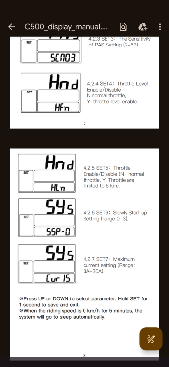

  1. Many thanks for that... I have the 250w version so will leave it at 13A
  2. Anyone know what this advanced setting 4.2.7 is for on the Yose Power C500 display? It says maximum current setting 3A to 30A. The default seems to be set at 13A. Any need to change that? Many thanks for any guidance

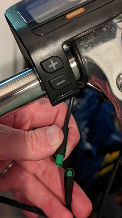

  10. Hi all, I have an Azor ebike that has a Bafang FM G311.250.V/D front wheel hub. It also has the basic display below. https://bafang-e.com/en/oem-area/components/component/hmi/dp-c11uart/ I'm wondering how easy it would be to fit a throttle. I bought the throttle in the attached photo. I'm a novice so please forgive the nativity but I was hoping that I could just buy a Y splitter cable that could be connected to the existing display connection i.e so that thele display and throttle could both run off that - see attached photos. Unfortunately such a Y splitter does not seem to exist (it would need to have 2 green ends and one yellow). Any guidance much appreciated.
