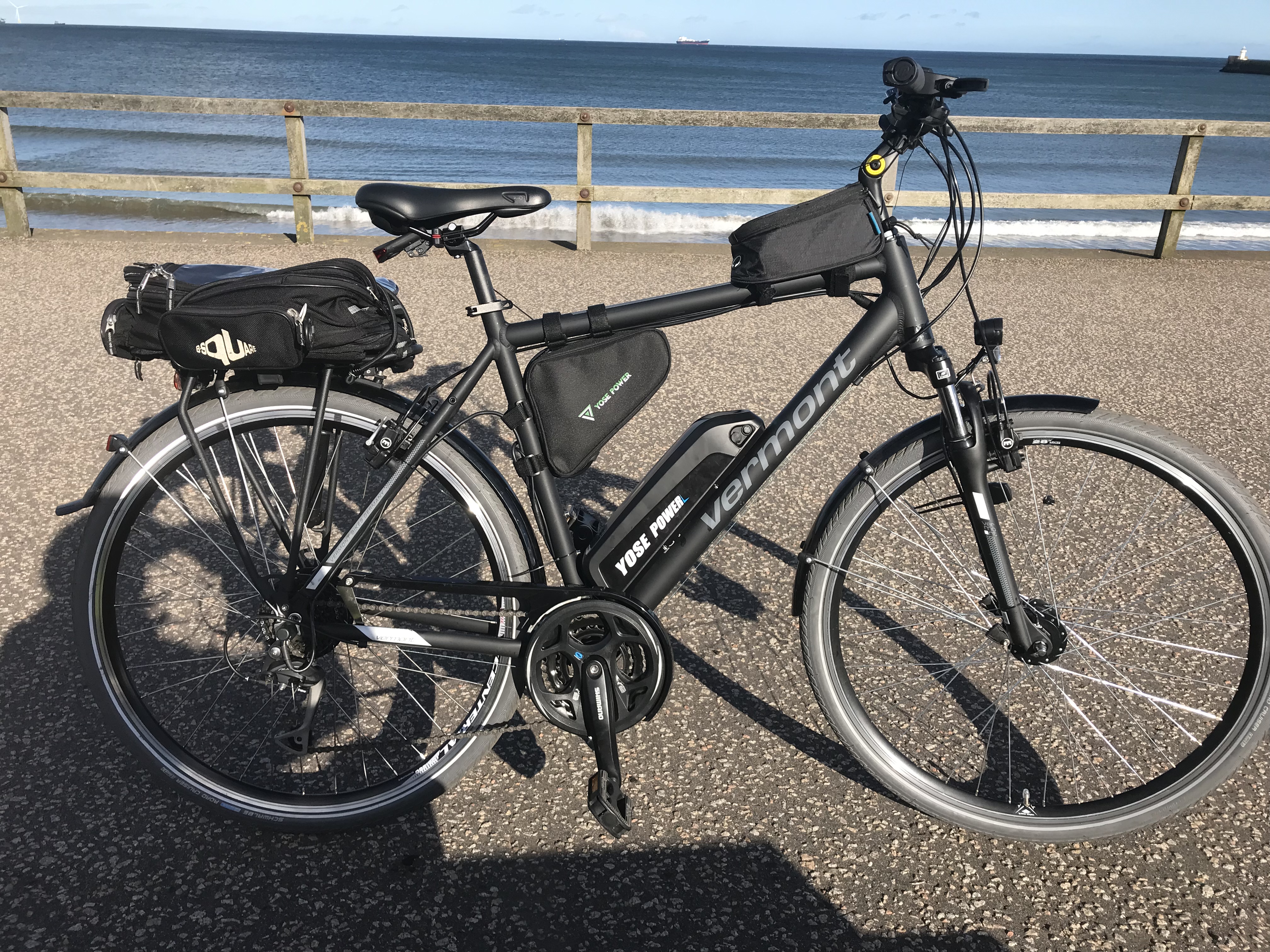

  1. Its the 350w 36v/13Ah, with integrated Lishui controller supposedly up to 18A, was out yesterday again and it just goes good! feels quick in traffic, so far good on inclines, tried some off road, integrates really well with the 24 gears, cadence sensor with slight delay to start no problem, comparing it to the Bosch cx drive I used for 6 weeks, which had 224mls on it, definitely liking this. The traffic here is terrible, lots of narrow congested roads , lots of irate drivers just now regularly cut up by them, this bike feels safer in traffic no doubt, I went for this kit for the lighter weight battery & motor combination seemed good value. Though its early days how reliable this will be and sort of pas/mls I can expect, I may want the 48volts later for increased range, i dont think I can just plug in a larger battery into to this controller, having read lots of great posts on the subject here.

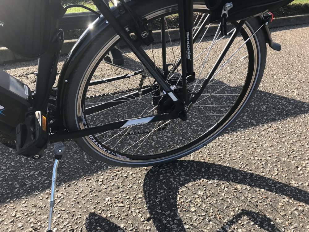

  2. The Yose power kit arrived quickly, complete with tools, it fitted without any real problems, minor adjustments to the battery holder bolts were sitting proud, the cable routing from motor to battery was a little tricky, I repositioned the motor cable down to avoid water ingress , and made slight adjustments to the rear derailleur 2-3mm it was a good fit and the rim is identical to the original, retaining the 24 gears is just ideal with the Hub motor, I tackled a steep incline yesterday and being able to use a really low gear assists the hub motor, I’m glad it feels a step up from my Giant and the Focus Bosch motor setup. I now believe I made the right decision moving on my other three bikes, getting a frame size that fits and the yose kit has worked out really good, and it goes good quick..
  3. Since its my first conversion I’ve gone for a Yose power kit , had a yose power battery on my Giant ebike was still going good 4/years on when I sold it, did look after it, if this goes well I’ll look at other kits, I’ll post details once it’s sorted and tested in the crazy traffic here!
