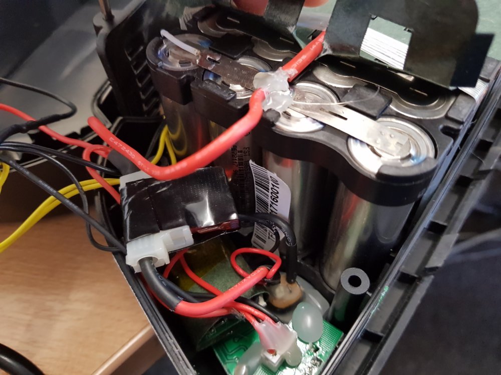

  7. Hi D8veh, Quick question if your around as I think I'm confusing myself here. The current (old) pack has the same number of cells (FST 2400mah) but is rated 15Ah, how does that work with cell configuration as I can only see 4 rows tabbed if I take a peek under the cardboard?

  13. I vaguely remeber 30amp but would have to check for certain, the current battery is supposedly rated at 15ah but i think it uses the same number of cells (fst 2400mah)? Think I’ll pull this battery out again and recount lol
