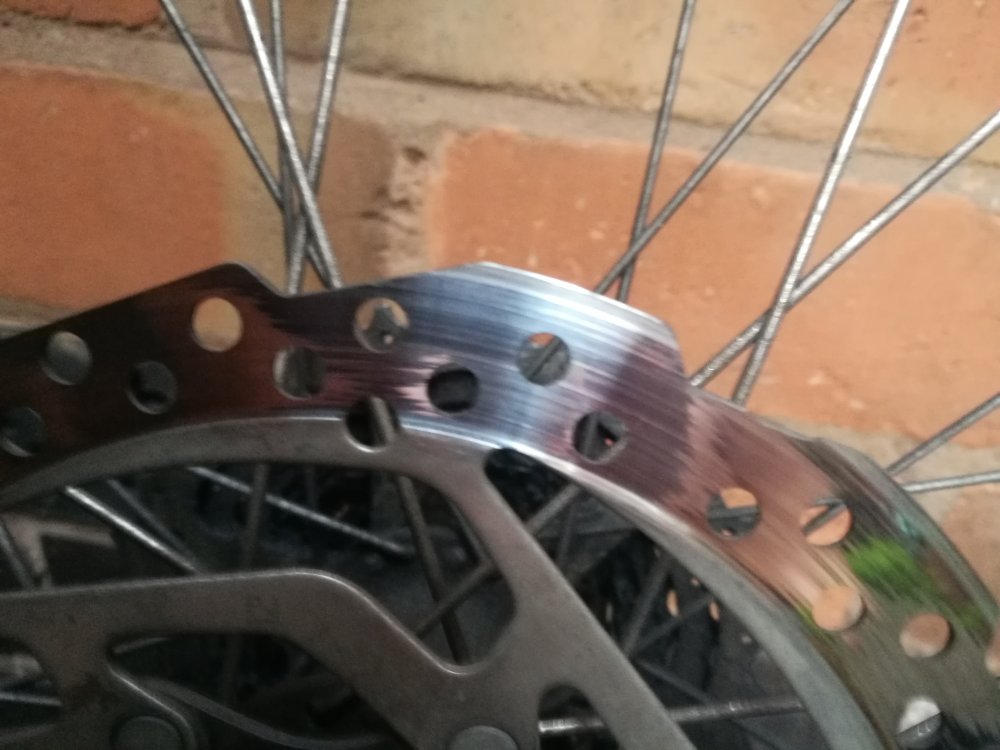

  7. I've reassembled the bike and put the pads back in - lo and behold the brakes a silent again beyond the normal hiss of pads being applied to disc. It won't last long though The calipers / brakes are Shimano M315 front and back. 160mm Centrelock Rotors (whatever centre lock means )
  8. It does look like it doesn't it? But there isn't one, not on either side. just a different shade of polishing by the pad.
  9. The ones I chose were made my Mexital to fit my calipers. I bought the sintered ones as they are supposed to last longer and I do a LOT of miles. I have found the genuine Shimano pads for my calipers on Amazon. They cost a bit more but probably better.
  10. the black on my hands is just brake dust, it's not oily
  11. Pics of the rotor and the pads in case you can see anything untoward
  12. These are actually brand new pads. They've done less than 500miles. They've been doing it since a few hours after I put them in. I will replace them again if I have to. It's possible wayward chain lube got on them but would that make them make a grinding noise?
