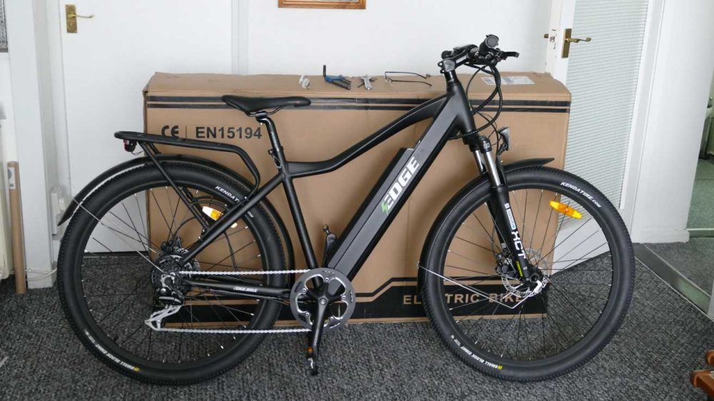

  5. Thanks fellas, I have another new chain for 7speed that's even shorter, so I'll use a piece of that as an extension. P.S. I came across a convoluted formula for working out the length...... in my case chain-stay length x 2 = 36.5 + number of teeth on the chain ring divided by 4 = 11.5 + number of teeth on largest cog divided by 4 = 8.5 add 1 = 1.0 chain length total = 57.5 ins.
  6. Thanks to everyone for your advice, I changed the bottom bracket today (that's another saga) and put the crank back with a new chain. I watched a couple of youtube vids first and I'm pretty sure everything is OK. even with the shorter chain. It seems the chain has more tension now but it's not too tight as there is still a bit of wiggle room for the derailleur ,and it runs through the gear shifting nicely.
  7. hi Nealh, I never once considered the length of the chain stay but now you point it out that would easily explain the need for different chain lengths, many thanks
  8. Thanks for your input fellas, just to add to my confusion I've done a bit more digging and come up with what seems to the right choice, but it's still a bit shorter than the original. The old chain is 122 links ! the best replacement it seems is 114 links and that's for a 6/7/8 speed gear train. KMC make nothing specific for 7speed ebikes, but another site says needing an ebike specific chain is a myth and to just use a regular chain. my chain ring has 46 teeth with a Shimano 7speed cassette. Can't take any pics because I'm changing the bottom bracket and have no crank on the bike at the moment. Think this chain will be ok ?
  9. Hi all, I have a 7speed set up on my bike and I've just replaced the chain, the thing is it's clearly marked as 7s, but it's a good 2ins. shorter than the original. All seems ok and I cannot see any obvious problem, but can anyone offer any reason why I shouldn't carry on using it as it worries me a little that it may cause a later 'wear'problem if I continue to ride with it. thanks daveT

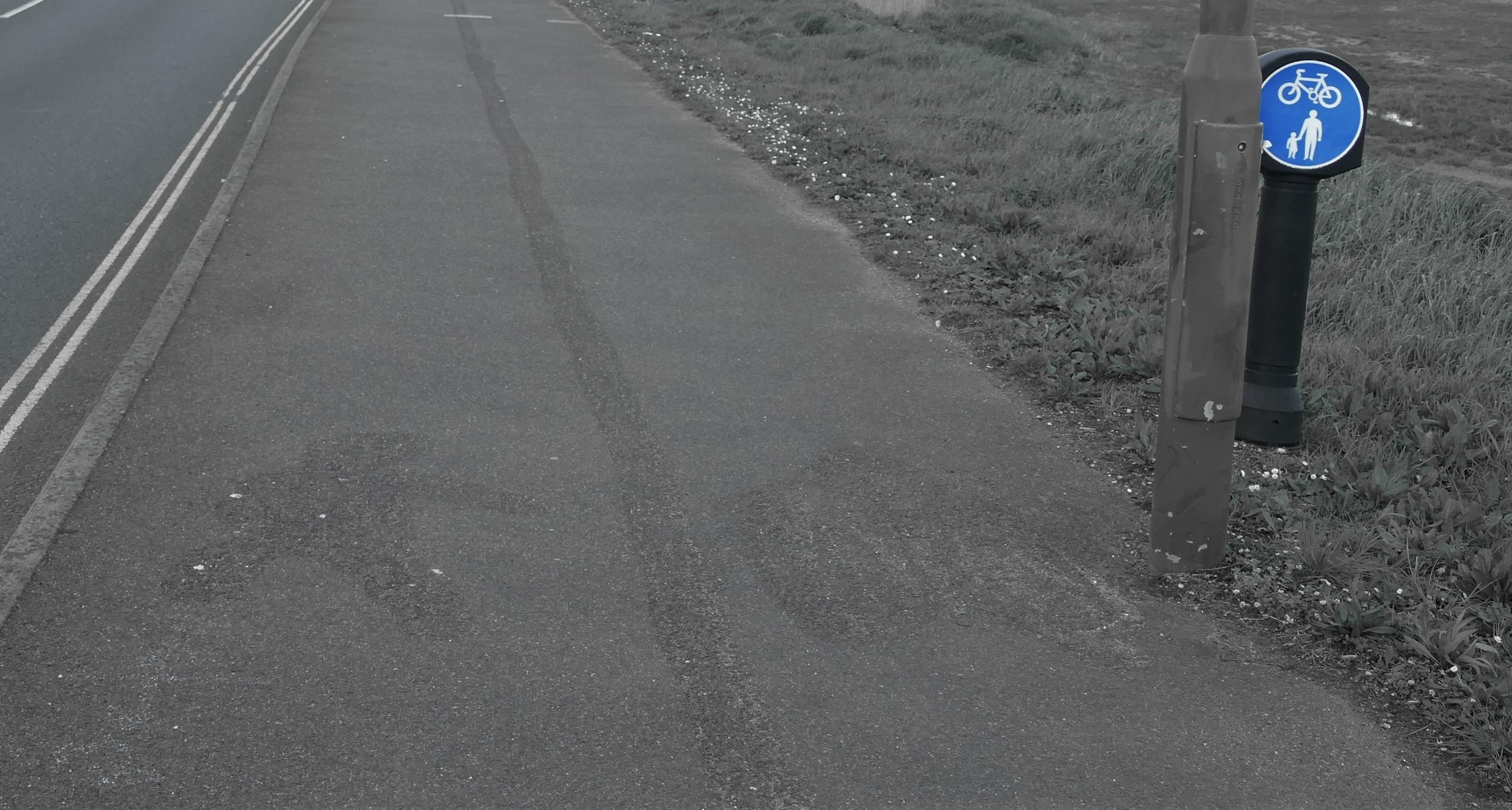

  14. Here I am banging on that we need more of these signs and what do I come across yesterday ? On another path they've been deleted !!
