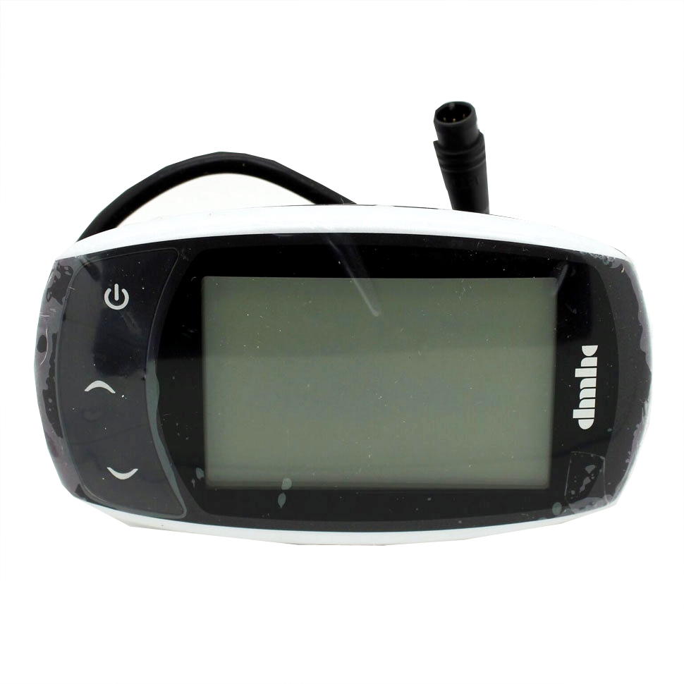

  13. I'll do that thanks for the heads up
  14. Thanks u will look at that.
  15. No its kept indoors and at work is in a covered cycle park. The display comes back if I twist the display slightly But vanishes when I release it again. The bike runs fine and the rest of display is clear just those 2 areas.
