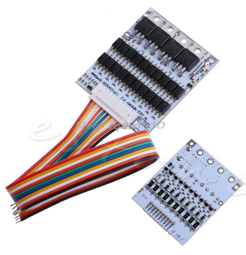

  10. Thanks for the prompt answer KirstinS. More specifications: The cells are this ones, I don't know what else info can I add: The BMS spec: The controller spec: Regards.
  11. Thanks for your answer, Wheeliepete. The cells were bought in gearbest and they are Samsung ICR18650 - 28A 3.7V 18650 2800mAh. I've welded them in 10S, so they're 40 cells. I did it following youtube/internet tutorials from ebikeschool.com among others. I don't have a spot-welding machine so I use my standard welder and niquel plates. The BMS should works with over 40A currents, as its specification. The components are the ones in the attachment.
