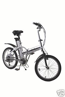

  5. Ok,here I am with a new folding bike and realized that I should have electrified my mountain bike. I think I am going to transfer all the electric components to the bigger bike,I am having problems finding 12 gauge spokes for the 20"wheel so I am going to get a 26"wheel built for 12 gauge spokes and electric hub, the longer spokes are easier to find.I have caught a glimpse of myself riding by store windows and at 6'2 275lbs I look silly on the folding bike. Can I eliminate the cutoff brake levers,my mountain bike has integral shifters and brake levers. Thanks,Jan
  6. There are only 2 wires going into the motor,I know because I put a small trailer plug to make the wheel removable.The battery has only 2 contacts on the bottom, and the platform has 2 corresponding spring contacts. Definately no controller. I saw an expoded view of a similar hub on another forum with 3 fets and hall sensors built into the hub. As to the pedelec it is a sealed unit with wires going into the motor. Thanks,Jan
  7. It is called an ebiko,2007,it is pretty much like the 2009 model.I have seen may other similar chinese bikes with a different name..The hub is quite large and very quiet. I assumed the controller was in the hub as well as it is not on the bike. 36 volt lithium ion 8 ah battery,no throttle just the large bottom bracket with the pedelec. Here is the website where I bought it Motion Urbaine | Motocyclettes, vélos, scooters, trottinettes électriques look under inventaire for fb250. And it is a bad thing if I was told it was absolutly brushless. Thanks ,Jan
  8. This may sound like a stupid question but do some brushless motors come with only 2 wires going into the hub? I know that brushless motors require 3 wires,but do some have the controller built into the hub as well? There doesn't appear to be any controller on the bike other than the large bottom bracket pedelec unit.This bike was sold to me as having a brushless motor. Could I add a throttle without too much problems? Thanks,Jan
