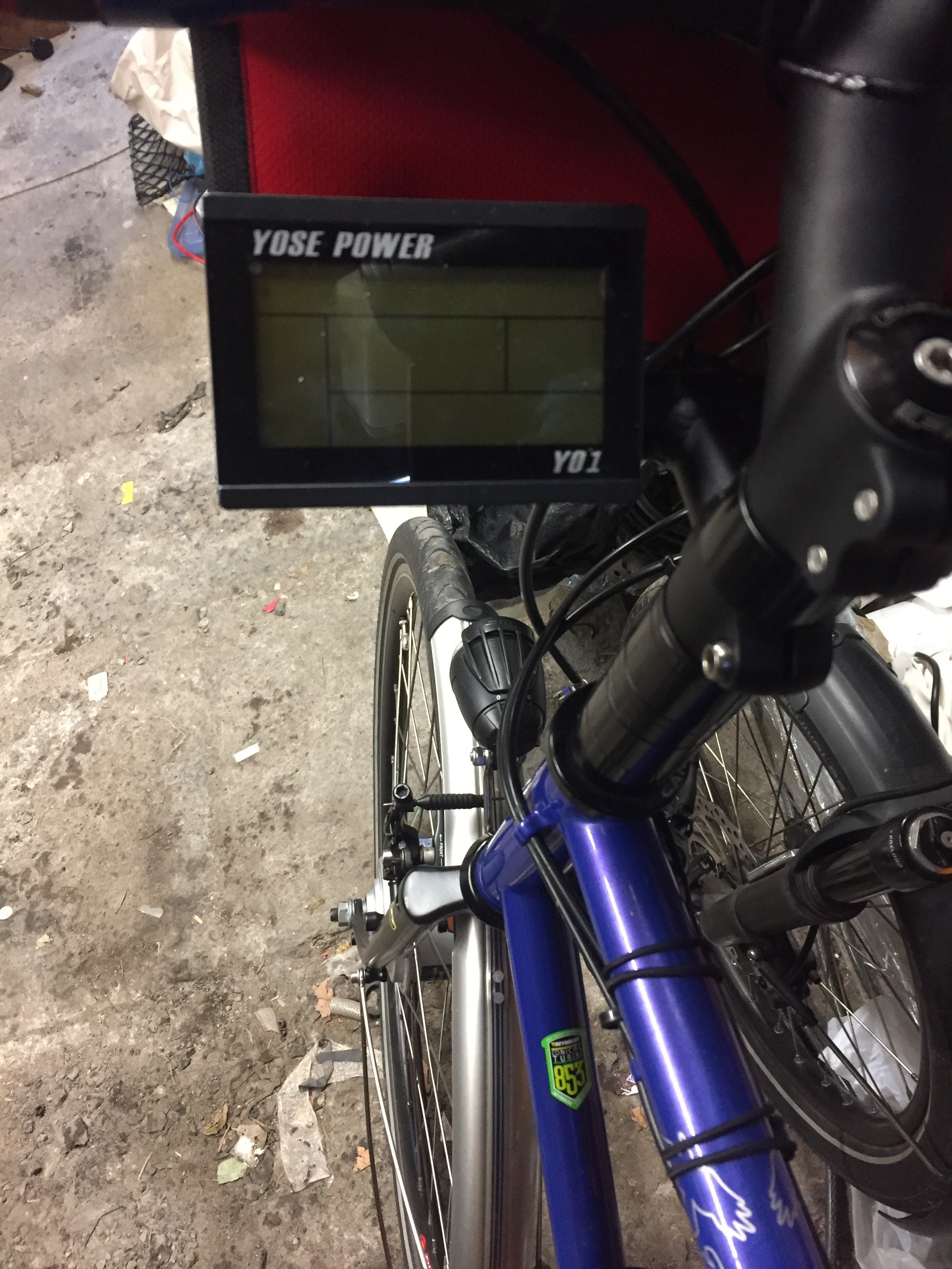

  9. Help with another conversion please? I recently bought a lovely used Rohloff touring bike which has also been converted to a front hub motor. It is a lovely combination and I would like to replicate the kit on my wife’s tourer. The kit was fitted by Electric Bike Sales Cambridge and from their website it seems to be a Sparticle. But the LCD is a Yosepower Y01 and seems to be a KT. I could get a kit from Electric Bike Sales but £700 seems a bit steep with a small battery. So can anyone figure out what I’ve got ( a Yosepower kit?) and where I can get another inc a pair of good size bottle batteries( one spare goes in the back rack). Some pics below. Thanks as ever.
