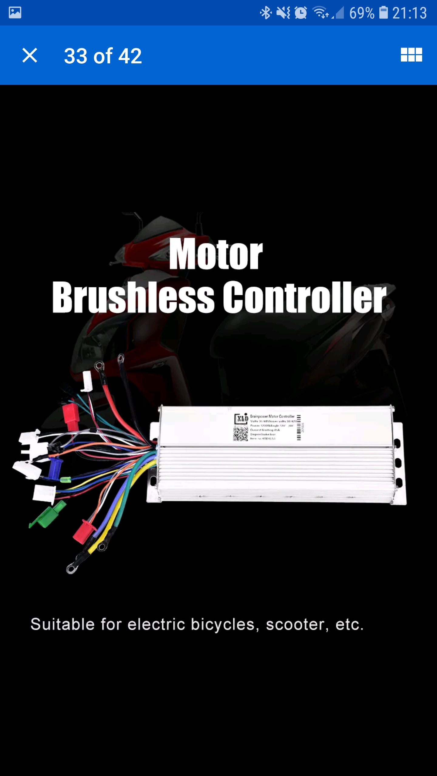

  4. Yes, it was the brushless one I'd selected and checked that it has the 3 phase wires (see attached screen shots). What kind of amps should I be looking for, ideally? Also, I hadn't selected an LCD screen simply because I didn't think I'd need one. If it's advisable then here's one for £15 more. https://rover.ebay.com/rover/0/0/0?mpre=https://www.ebay.co.uk/ulk/itm/323396809738 However, found this 24v 500w 30A brushell controller on Aliexpress. Under £30 delivered. https://m.aliexpress.com/item/32610339800.html?pid=808_0000_0101&spm=a2g0n.search-amp.list.32610339800& I'm also not clear on the whole sensorless thing. So if it's all going to get too complicated for a newbie I'll might just count my losses and walk away before I end up spending hundreds of hours and pounds on something that will hardly get used. :-/
