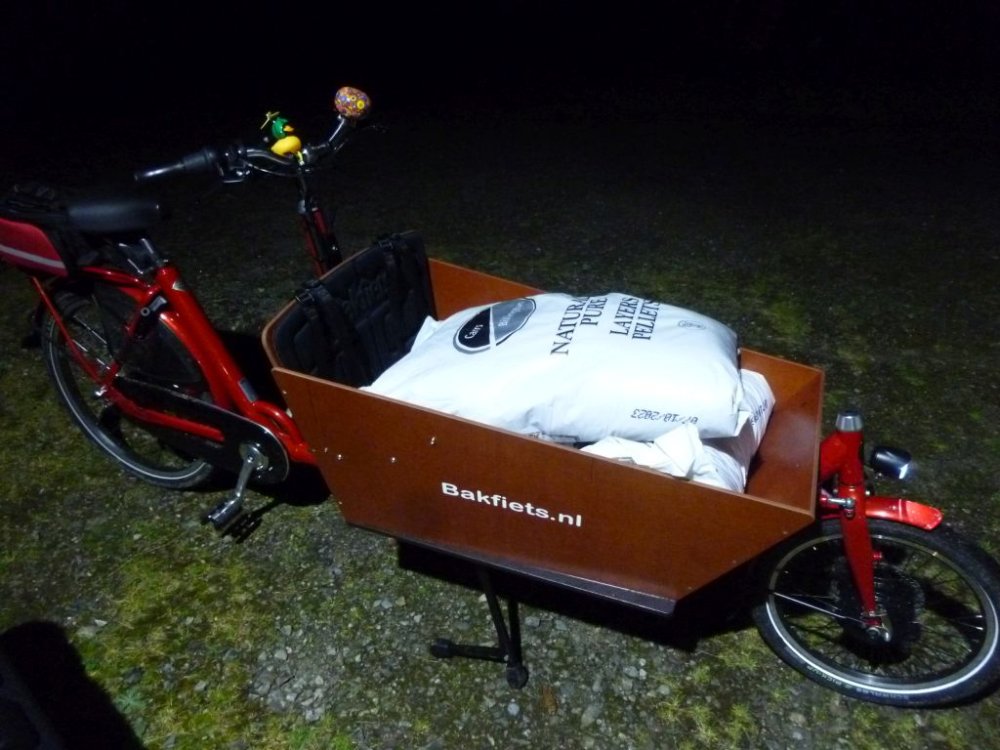

  11. It's carried a fair amount of stuff. Wouldn't do this everyday, but here's it loaded with 75kg of chicken food
