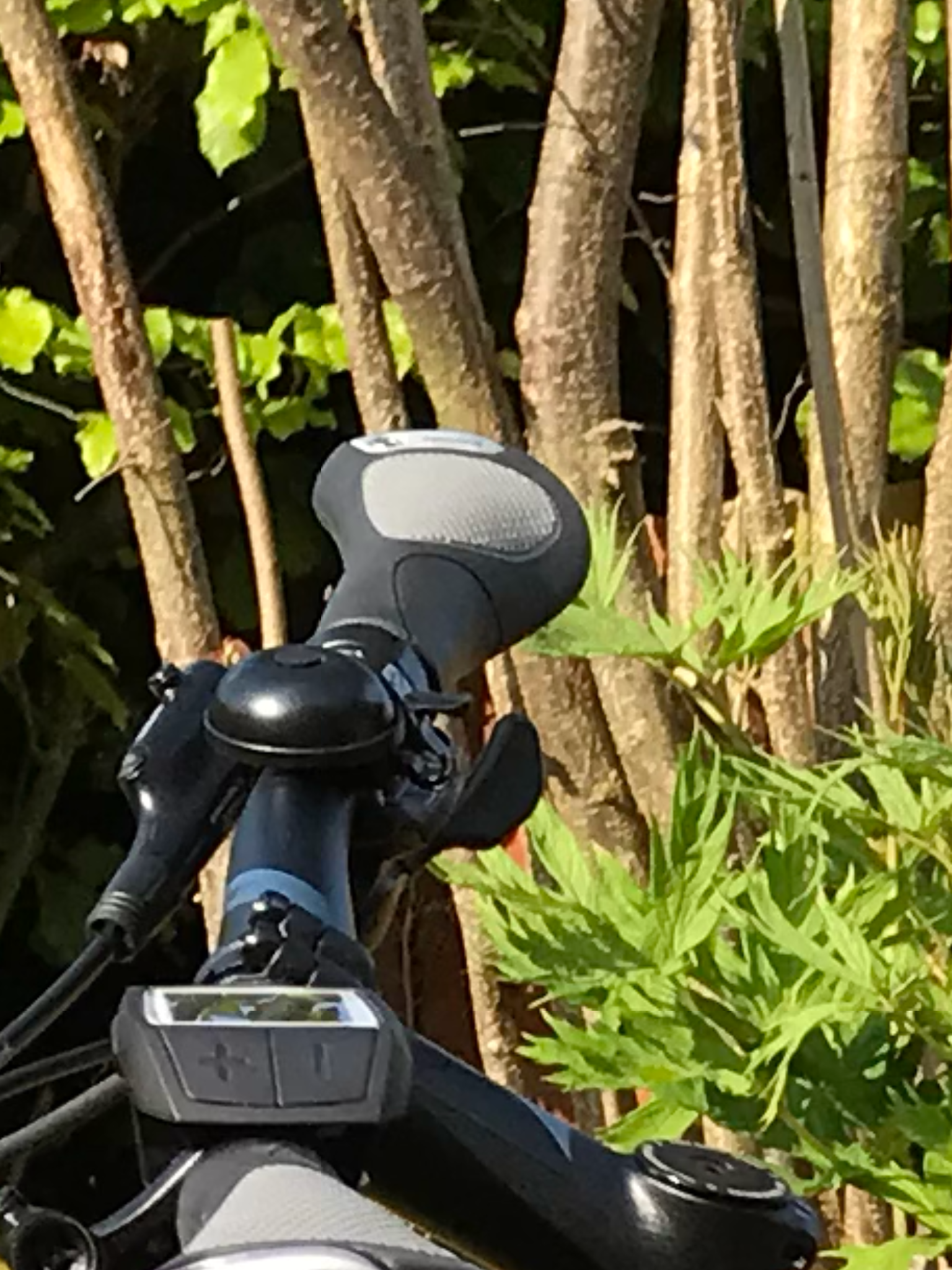

  2. 1st 1000 miles completed today riding a Cube Touring Hybrid One 500 Been fantastic, really enjoyed being out on it. No major disasters, no flats (not sure I should have mentioned that, will probs get one now) only failures being chain which snapped at approx 750m (only had to walk about 2 miles home phew! ) (now upgraded to KMC E9 EPT 9 Speed E-Bike Chain) & front lamp bracket snapped due to it being a poor design/construction & just failed on a poorly surfaced road (replaced foc by dealer) done 1 or 2 mods, shorter stem with a stem raiser to reduce pressure on hands, 2nd set of grips (couldn’t get on with the Ergon GP1s, have reverted to Cube Foam grips. 3rd saddle, tried a Selle SMP TRK & now on a squidgy Respiro Relaxed. Only generally use it for pleasure rides (about 30miles is usually my max) usually ride in “Sport” & find battery range good for 2x 25 mile rides between charges.

  4. I’ve had my Cube Touring Hybrid One 500 for about 4 months now, OK haven’t put a vast amount of miles on it (approx 270) Finding it difficult to avoid “numb tingly hand” syndrome, my dealer adjusted the positions of the brakes & shifters so my thumbs could correctly wrap round the grips but I’m finding I seem to be exerting too much pressure onto the bars & have to often relax to alleviate the numbness. I’m tempted to change the stem to an adjustable one & experiment with the grips , I’ve fitted the Ergon GP1s but not really getting on with them, anyone had success with foam/gel grips?

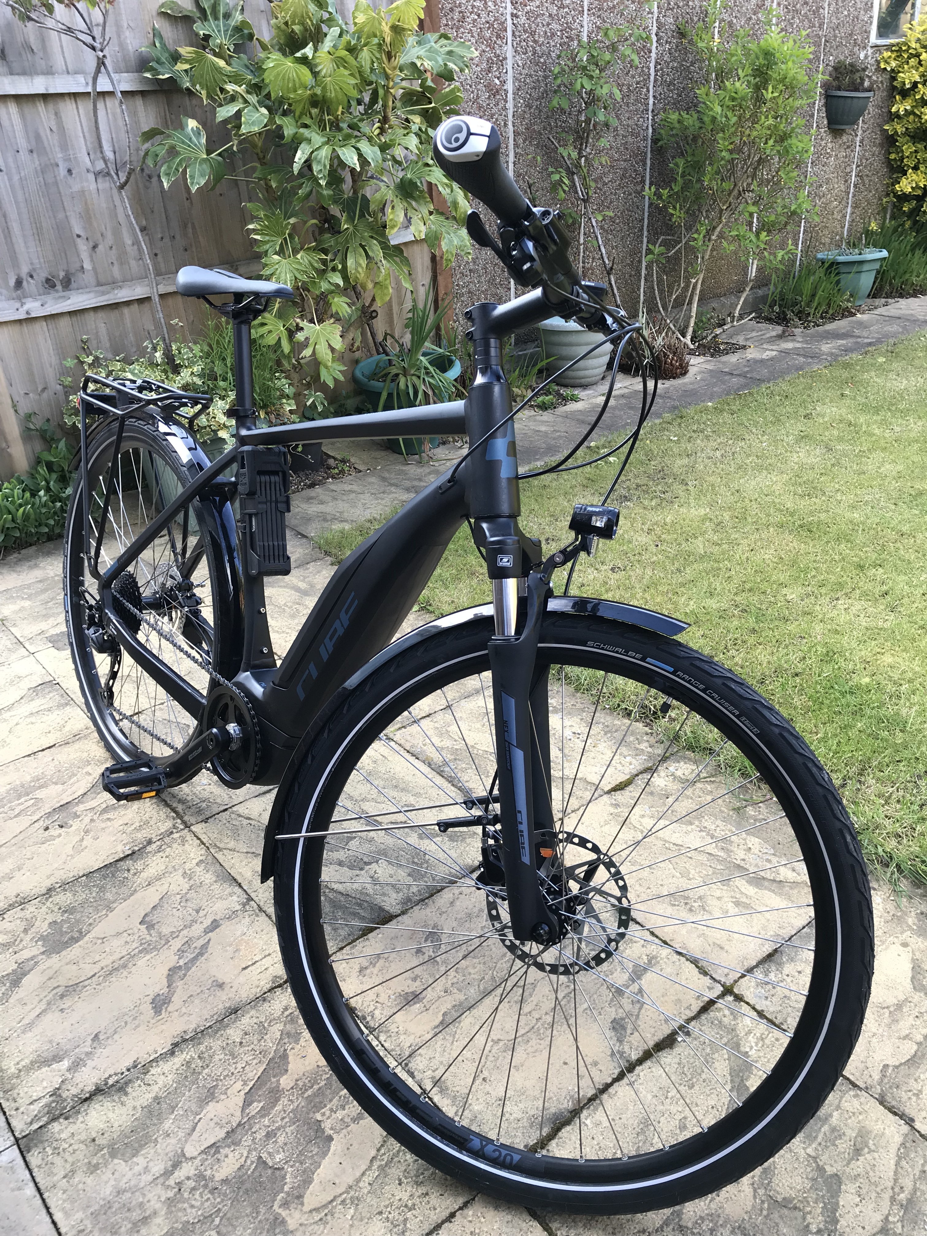

  7. Not sure, seem ok, had them fitted when I bought the bike. Will look into it. Thanks.
