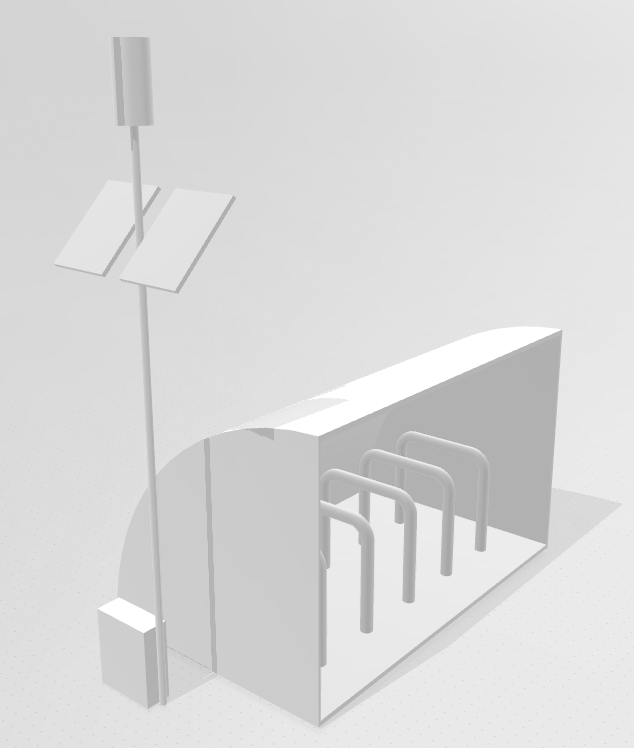

  3. That was my original plan to install a PV panel and a small wind turbine that would charge a big lead acid battery / inverter as I do at home, I was even going to pay for it out of my own pocket, the firm I work for is involved with green energy so it would be a great way of showing their green credentials to visiting customers and clients however they refused to even discus it, ( we had a contingent from NASA once and they were standing around my bike, man was that cool!!!). There are 6 car charging points in the car park that I could possibly find a way of using but I'm pretty sure the staff are not allowed to use them. There is about 8 e-bikes at work now so a communal charging system would be really good.
  4. Ok its been a while so thought I would give you an update on this. To recap, I needed a way to charge my bike at work ready for the long uphill climb back home after my work moved to a new premises without any bike shed charging facilities. The 14 mile home journey consumes around 8-10Ah depending on wind direction up in the hills ( I ride through a wind farm ) and the depth of mud in the forest / swamp (more than once I have had constant wheel spin for over half a mile which is awesome fun!), the battery often gets hammered on the way into work as there is usually a brutal head wind blowing down from the Pennines. I chose to build a portable battery/smart charger unit that can be charged up in the work shop and carried out to the bike shed, then after about 3 hours its brought back in and recharged ready for the next day. It didn't cost a whole lot as I had 15Ah worth of LifePo4 cells from a previous project and several military spec DC/DC converters (don't ask). The unit will charge my battery at 42.0V / 2.0A and cut off when the battery is charged incase I get called away from work. The charger has now been in use daily for exactly a year, my bike has covered over 32,000 miles in 6 years but the most impressive thing is that the charger alone has now covered 62 miles in 12 months from being carried out to the bike shed and back!!
