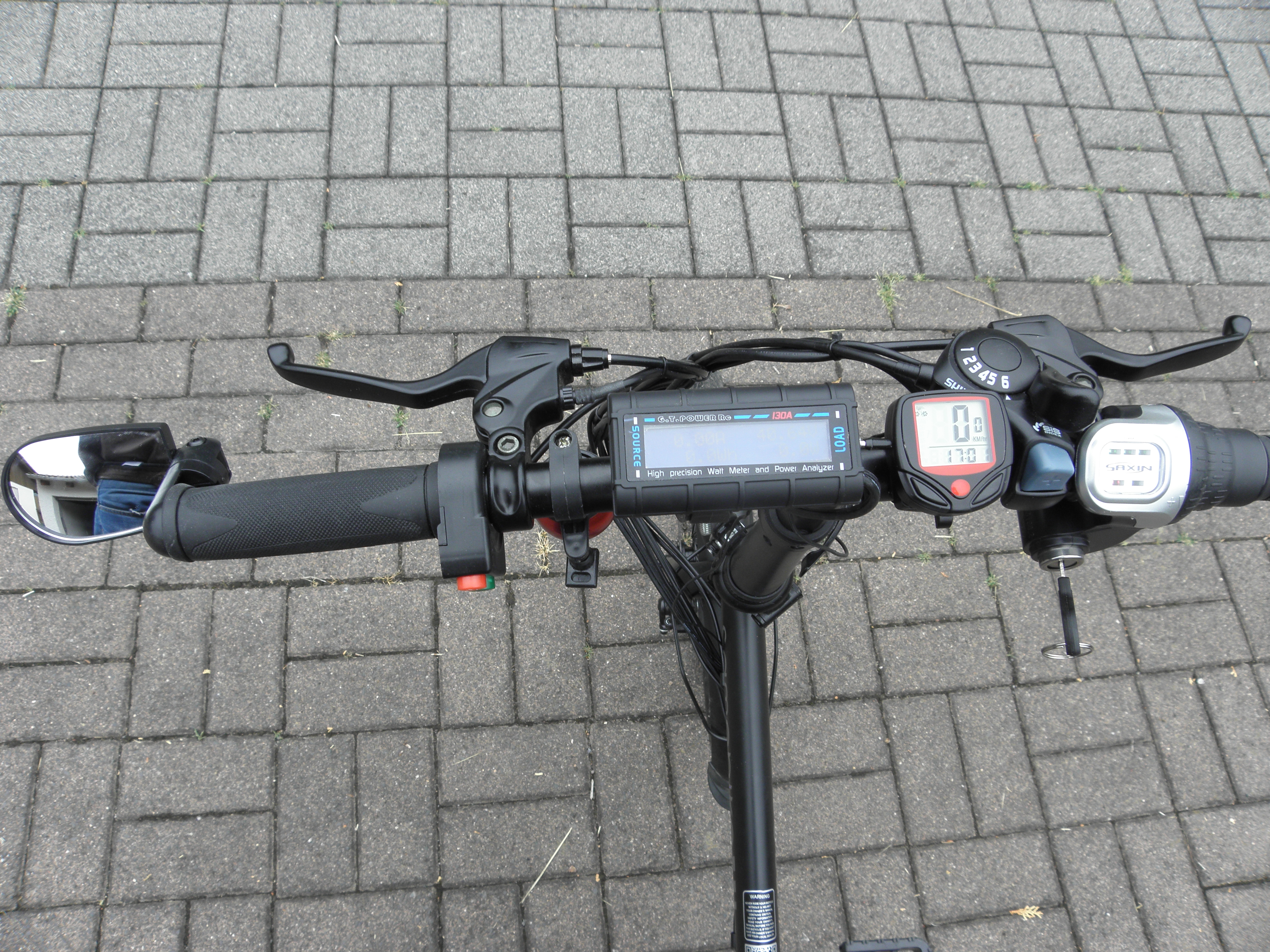

  3. Sorry, I have not updated this topic for a while, was too busy fiddling and riding... Here is how I solved my issue with this ONE-POWER-MODE controller, as I could not reset it to the factory mode of Vmax=20km/h: As the PAS would always trigger the full power mode whenever pedaling I made it optional, adding a switch to the handle bar. This way I can disengage the PAS and control the electric power manually at will and ANY level, using the handle bar gas grip. Meaning I can adjust the power output for any desired speed up to Vmax, but have to hold the gas grip, like on a motorcycle, while pedaling along. Range of the 288Wh pack is now back to 55-60km for a single charge (from around 40km with PAS active), around 5Wh/km, cool! I did some very nice trips with the modified bike, at avg speed of 20km/h, perfect for the 20inch wheels and high cadence gearing. I also invested into a GTC power meter to watch over power output, true battery voltage, power consumption etc. It allows to see the actual wattage, the accumulated Wh consumed, the battery voltage and amps under load etc. The cheap meter (which is usually bought and installed for solar panel monitoring) is very accurate (home bench testing) and very useful for this bike with its anemic 3LED power display. But I found a few very surprising facts when observing the readings during my rides: - a 36V battery really has around 42V when fully charged, so it contains TEN elements of 4.2V? - even during regular rides the battery operates way above 36V - under load the battery on this 250W bike is drained with up to 13Amps, around 480W! Why a 250W bike will operate at almost twice the power (at regular speeds below 25km/h) I cannot explain, but it is a fact for my JG20. Does the full power get to the motor, or is it partly consumed by the controller FETs? Cannot say. Also interesting is the significant voltage drop of the battery under load, a typical effect of these Li ion packs: at full throttle and power the voltage may drop from 39V to 36V or lower, recovering quickly when the load is released. This behavior is very unfortunate for folks like me who live on TOP of a steep hill. After a trip the battery may be down to 35V already, still containing 'juice' for another 10km or so. But a steep hill climb will squeeze the voltage below the shut off trigger point (around 33V?) and will NOT allow to restart the motor afterwards, bummer. I ended up pushing the bike uphill more than once.. The season is over; I rode about 550km with this weird Samebike JG20. It IS fun and WAS cheap, it DOES work, but needed the special TLC and mods to become a useful vehicle. Would I buy it again? Not with the simple and poor controller and display it uses, not with the bad gearing ratio of the Shimano set. A conversion of all controller electronics or the Shimano sprocket sets would cost more than the bike is probably worth. My own solution set me back by 7Euro for the PAS shut-off switch and the GTC power meter - well spent! Thanks for reading and your suggestions; I learned a lot about pedelecs this year!
