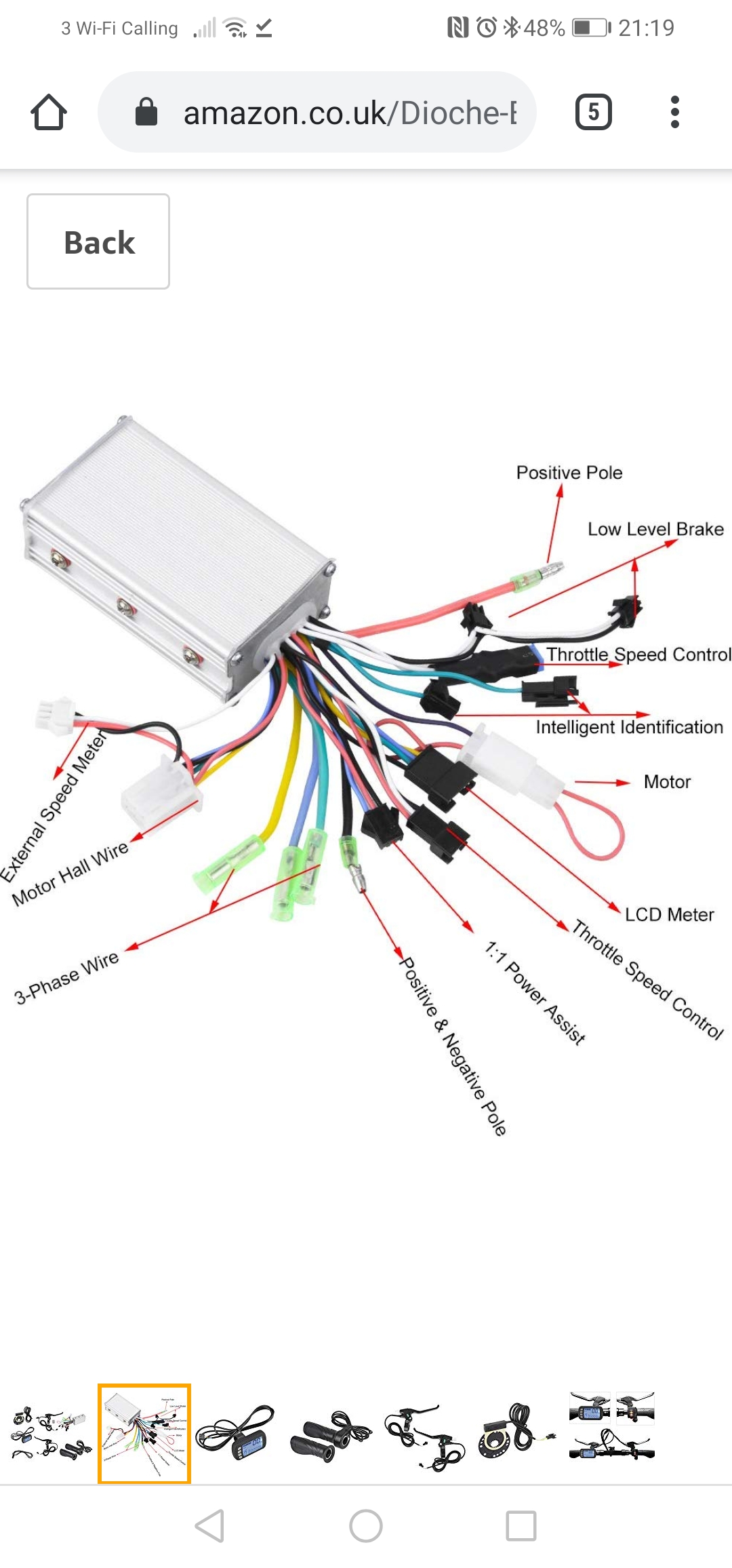

  2. Hi All, I recently killed the original throttle on my Fiido D2 and have bought a brainpower controller LCD and throttle kit. https://www.amazon.co.uk/gp/aw/d/B07MPV259Y?psc=1&ref=ppx_pop_mob_b_asin_title The kit looks pretty simple but I have a couple of questions: 1) can I use the existing stock PAS system or is it best to swap it out? 2) I have a light/horn and a usb on the bike and wondered if I easily get this wired in also? This is the wiring diagram Thanks in advance for any help. Paul

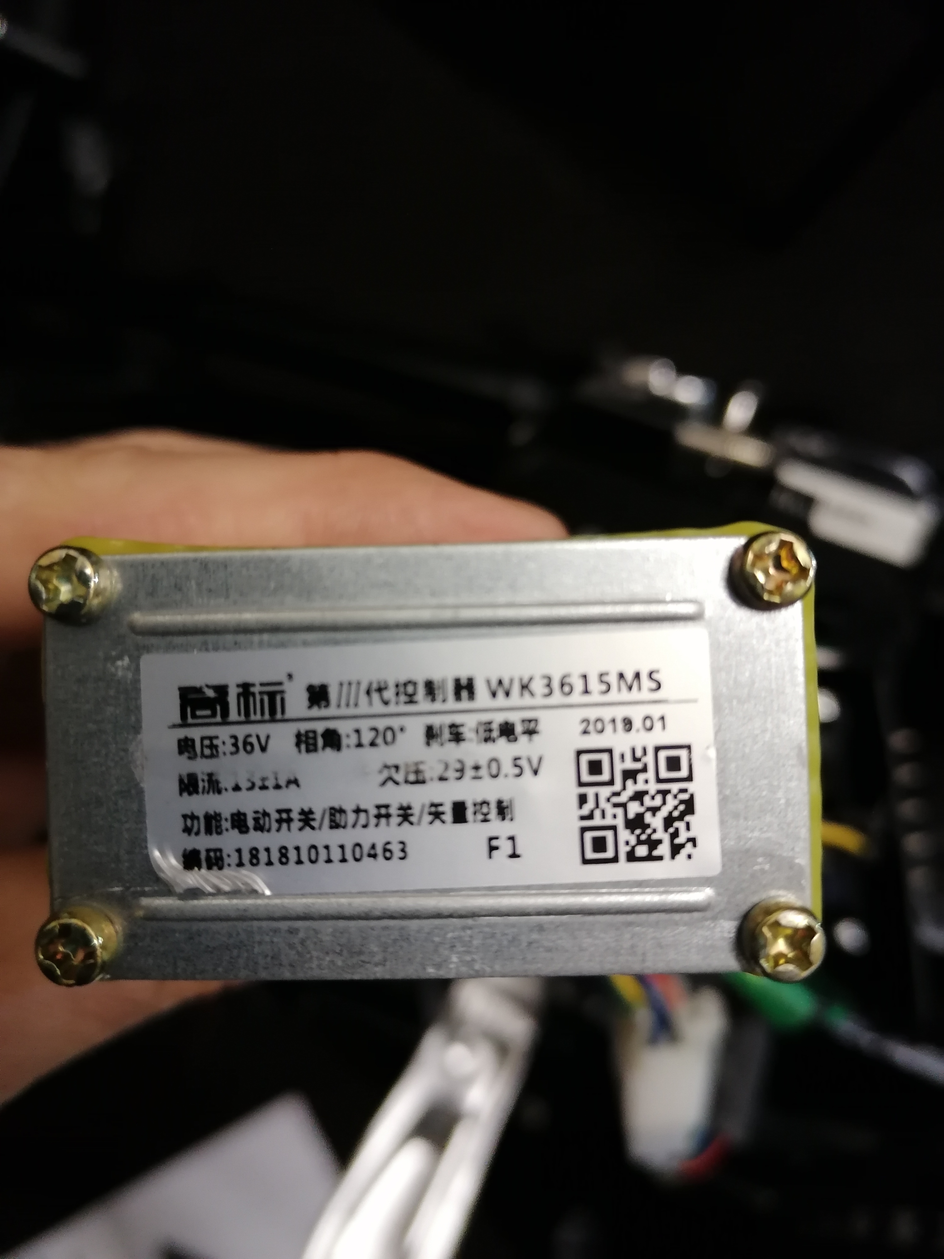

  6. Hi Ross, It's a WK3615MS fiido stock controller. Thanks Paul
