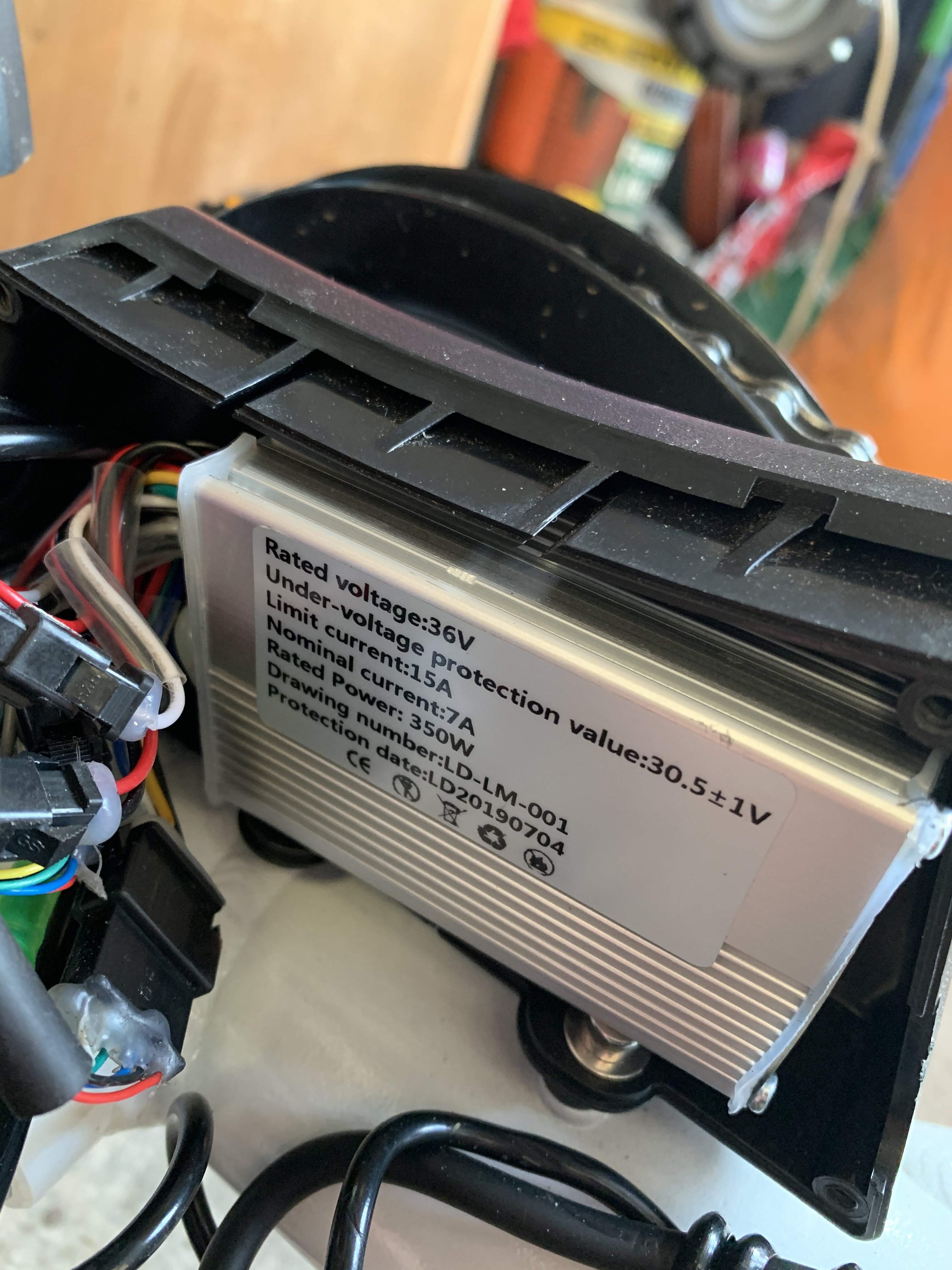

  2. No sign of any shunt can you recommend a better controller for more power?
  3. I am going to look in the controller this evening! But can anyone recommend a controller to give more power. I am not worried about killing the battery
  4. Thanks for this, I will take the controller apart and have a look. Is there a better controller I can buy? I live at the top of a big hill and the bike really struggles to get up

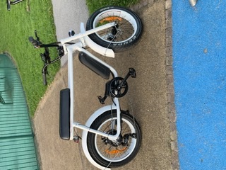

  6. https://www.redrocketlifestyle.com/product-page/copy-of-the-rocket-88-black-with-tan-trim-black-wheels
  7. Link to the bike
  8. Specifications 1. Frame: Alloy 6061,Suspension frame 2. Fork: Alloy suspension 3. Handle/Stem: Alloy PROMAX 4. Rim: Alloy 6061# double wall rims 5. Tire:20*4.25inch fat tire, KENDA K1032 6. Battery:36V10.4Ah lithium battery, Removable battery 7. Motor:brushless,DC motor,rear drive 36V250W 8. Display:LCD display, 5 level PAS speed 9. Controller:36V, brushless hall controller 10. Brake:F/R disc brake, ZOOM 11. Derailleur Shimano 12. Hubs: Shaft Hubs + Quick release 13. Front round light included 14. Fenders included 15. Luggage Rack 16. Black wheels

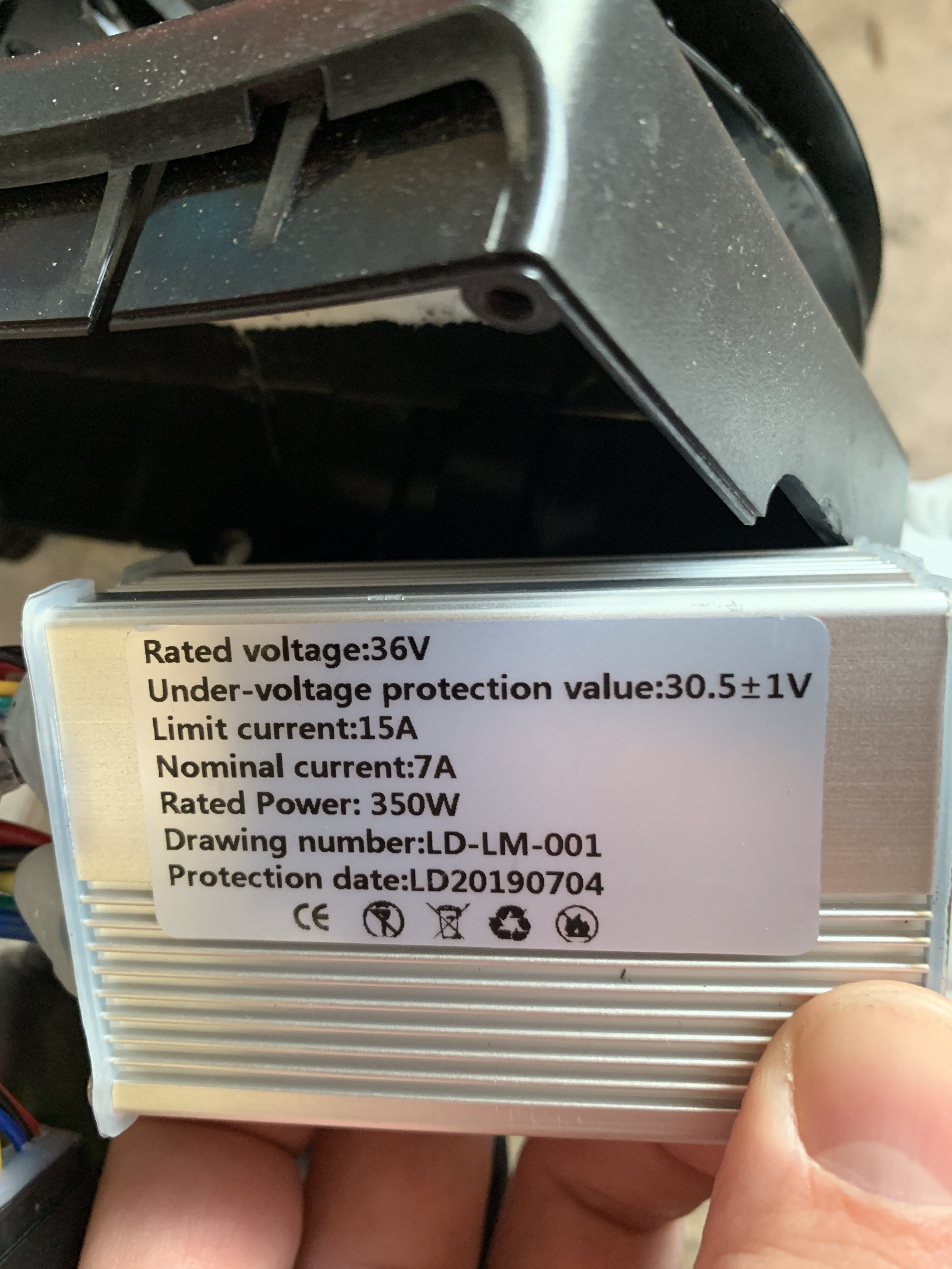

  13. I would like to swap my rear fat bike 250 hub motor for 500w for a bit more power going up hill. Can I get away with just swapping the motor? Or do I need to swap any other parts at the same time, like the controller and LCD display Im told the current kit is Bafang! Has anyone else done this before?
  14. The LCD is a C961 (good spot) and I have attached a picture of the Controller. Is the C691 a decent unit? Is it worth upgrading? Thanks
