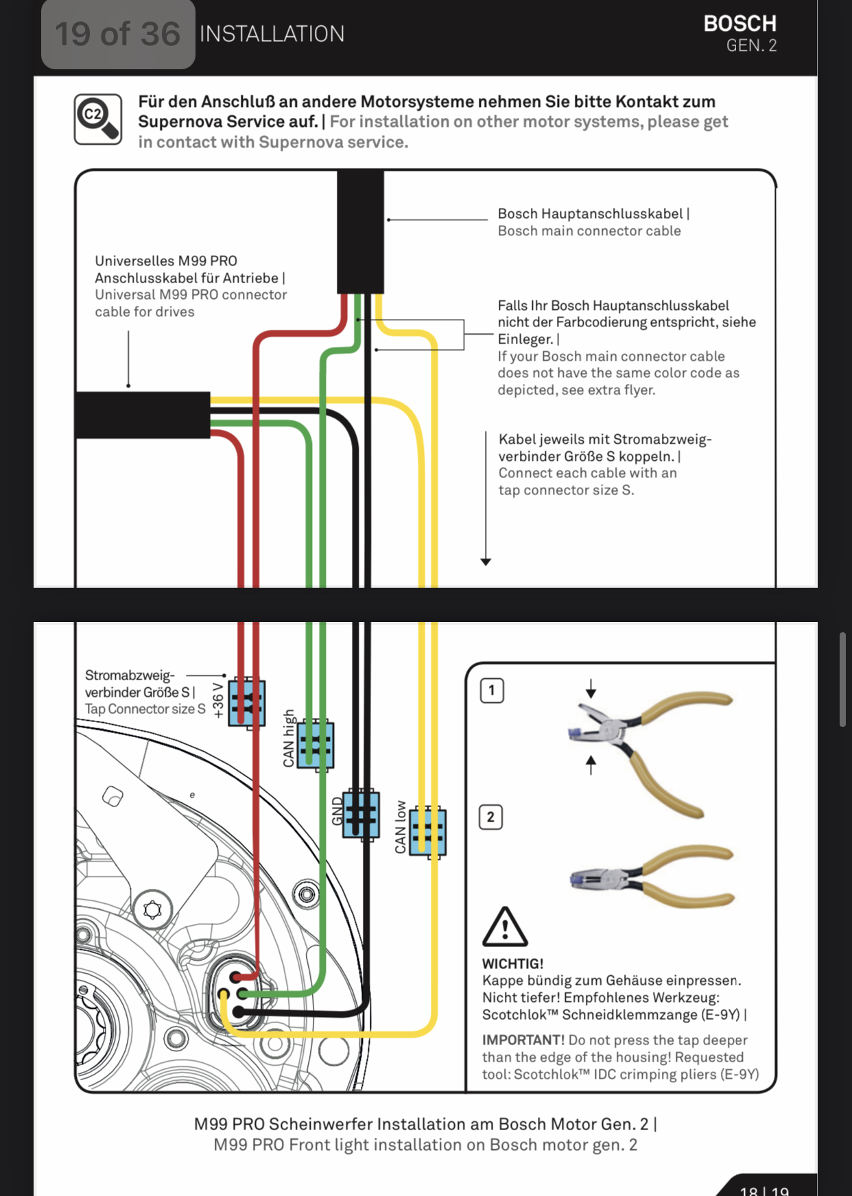

  7. Some hopefully good news. I went for a ride today and normally I have two batteries attached like in the picture below but today I only used one battery. I tried using both the top and bottom battery holder and only when the battery was in the top one it kept giving me errors. I’ll do some more testing this week and hopefully it’s only a case of the top battery ports needing replacement like the OP stated. I’ll try some really bumpy routes too many coincidences so I won’t get my hopes up just yet lol.
  8. The light is is honestly amazing so I’d be hesitant to sell it. Nothing comes close. It has a gorgeous day time running light around the edges, has a low and high beam, and automatically comes on when it’s dark or when I’m in a tunnel due to its sensor. From the technical specs it says: 24 V – 60 V DC (75 V max.) So I don’t think it’s physically possible to attach it any other way apart from directly to the battery? Supernova who make the light is a well known Germany company so I doubt they’d sell something that isn’t compatible. I have contacted bosch and Riese and muller to see how they connect it in the factory and if they have had any complaints. I was reading about “voltage sag” which means there’s less voltage if the motor has to work harder on hills. The light does take quite a bit of power so I wouldn’t be surprised if that’s what’s causing it. if not I’ll take it to another eBike shop to see if the original bike shop installed it badly. p.s. here’s a picture or the light for you to admire

  10. Thanks for the reply. I’m attaching a page from the manual for the m99 pro light. This is how it was connected up (they crimped and then soldered when I returned to the eBike shop due to the 530 errors). Do you think there’s any chance it’s because of a loose solder connection with the new light? Or is it just a coincidence that it started happening after the new light installation?
  11. Aah my bad. I thought you replaced the actual (female) socket inside the battery. I did give the terminals a good clean today and it worked well but after I started going up hill and had a few bumps I kept getting 530. I’ve got two battery terminal on my Riese muller delite 2019 so I will use a single battery for now and test each terminal. I’m still thinking that it might be a loose solder connection between the Supernova M99 Pro light (which my eBike store installed for me) - this is connected to the battery. The m99 pro uses the 12v connection straight from the battery since it’s so powerful. Since it’s a series circuit then I assume it the light loses power for a second then the whole circuit breaks which causes error 530. I may be wrong. They tried crimping it originally but I also kept getting the error so they soldered it instead. Anyway I’ll keep investigating. Cheers
